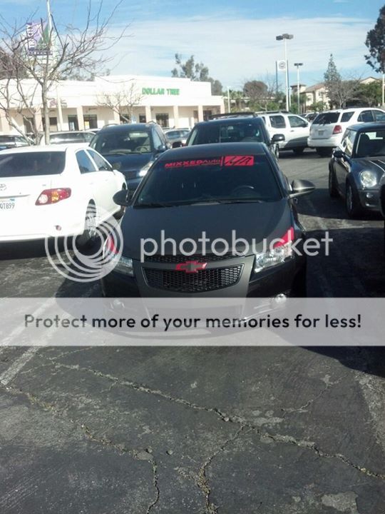

    Side note, seeing as you are based in SoCal, if you ever want/need any vinyl work done check out Mixxed Auto Design. Corona/Mira Loma based company owned by my buddy, who recently wrapped my room mates trunk, roof, hood, and center front bumper in matte black:

    Thanks for the great response man! Yeah doing it myself really scares me after further research. But if you read my response above, do you think that would smart to do or no? I was thinking I can pay the guy who did my windows to do my roof for cheap, then buy only maybe 20 yards or so of the 1080 vinyl for everything else?
    Also, your buddies cruze looks sweet man! Love the front bumper and the red accents.
