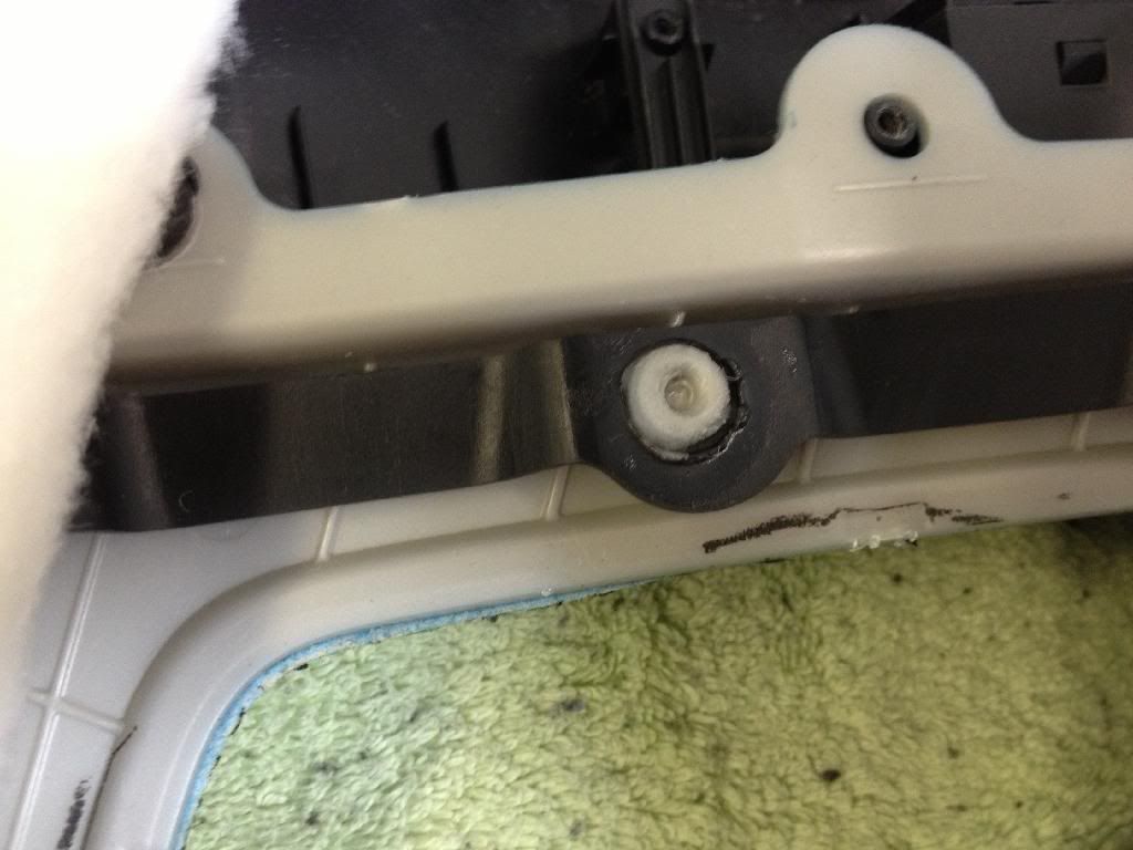

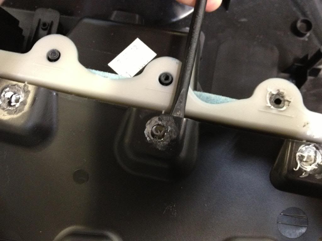

So yesterday got the interior done, minus one panel, which I'll be doing when I get done posting this. After taking the door panels off I had to tear them down, which really isn't that difficult. The hardest part is taking the cloth trim off which is held on by plastic welds. They look like this:

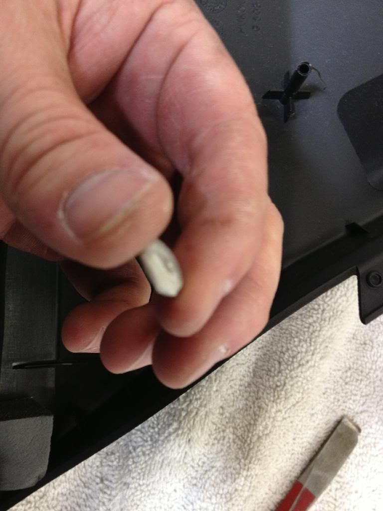

I use a gasket scraper and a hammer to take them off. When you cut them off this is what you should have cut off:

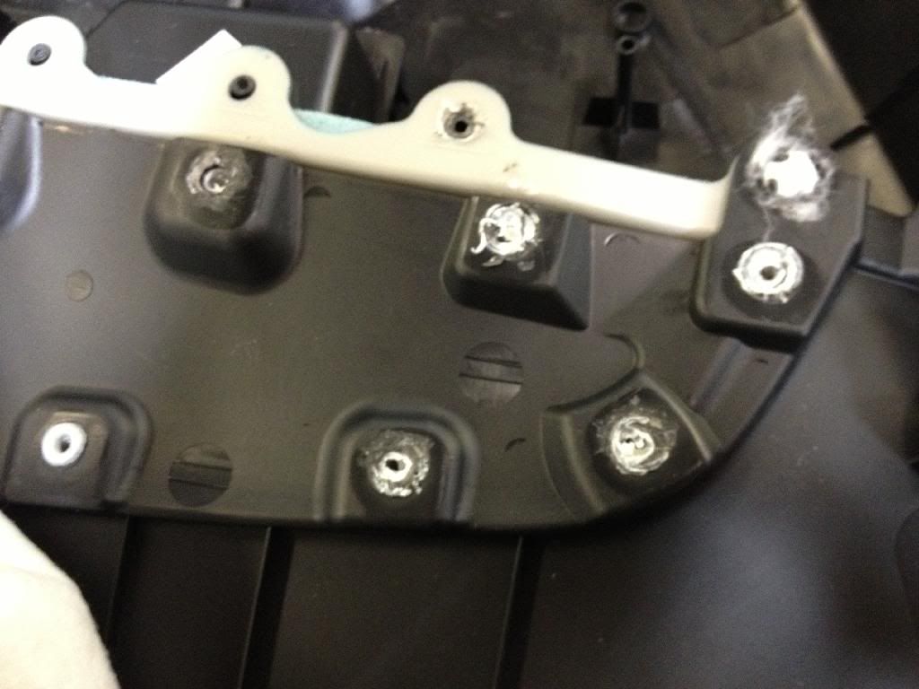

and this is what the backside of the panel should look like after you start cutting them off:
Sometimes the plastic will still be held together so I used a flathead to separate the pieces:

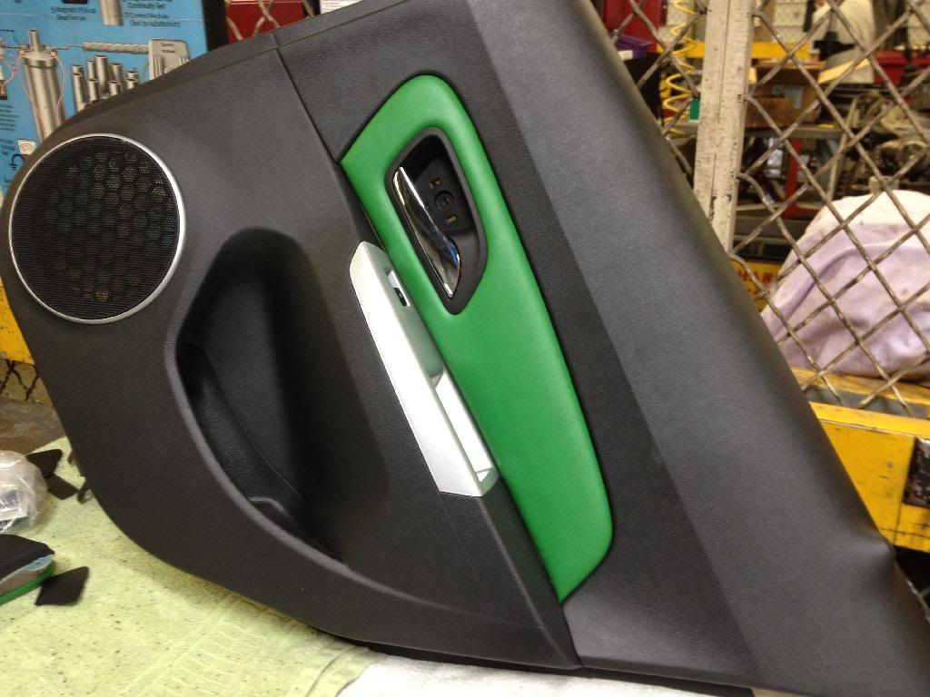

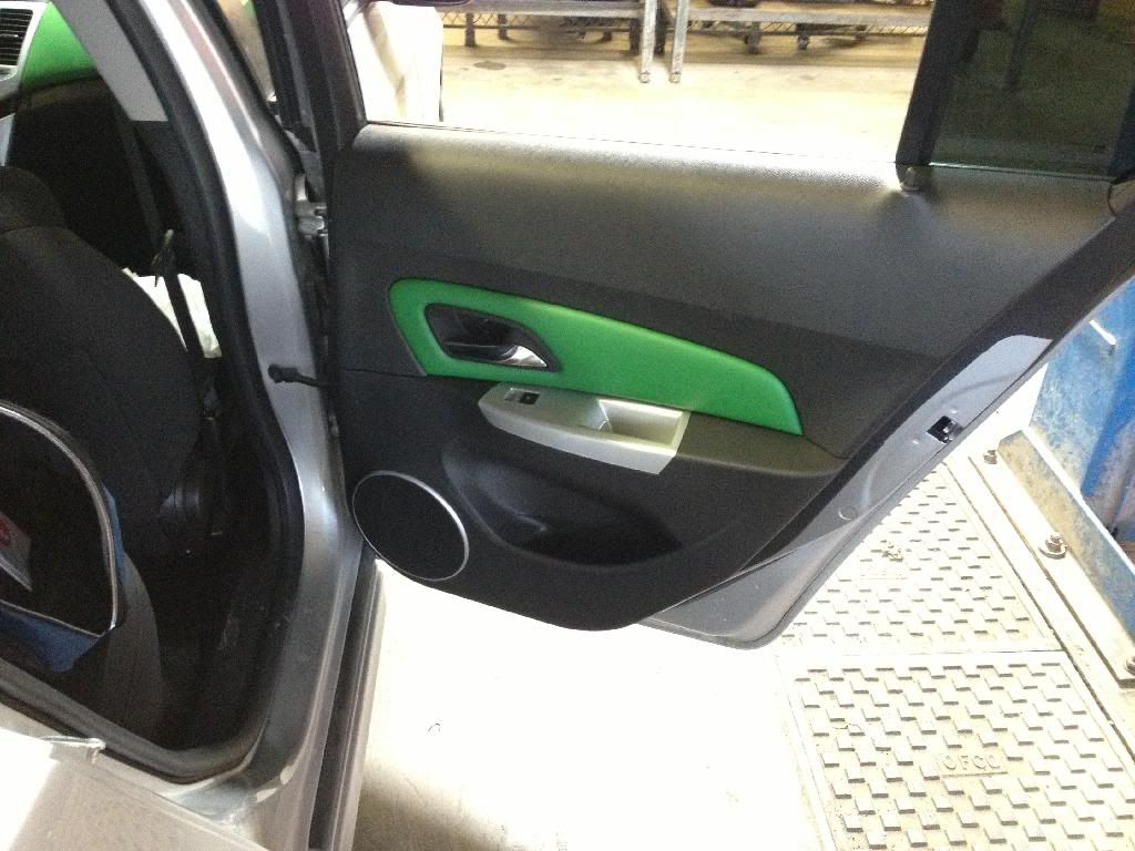

When fully assembled, the door panels looked like this:

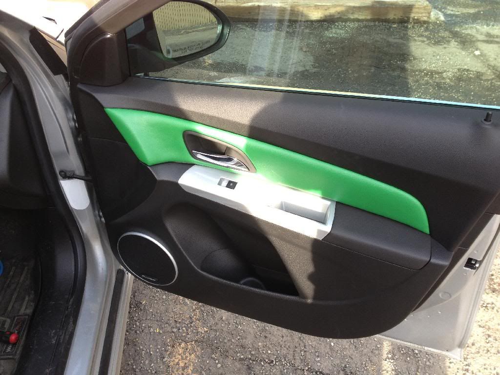

This is the front and rear, installed:

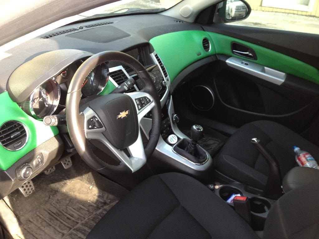

This is the look of the finished interior:

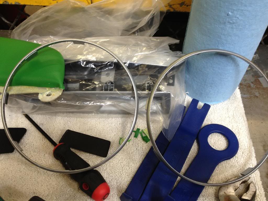

Earlier someone had said the original silver parts looked the same as the ones in mine now. The ring on the left was painted, the one on the right is originally what came on the car:
