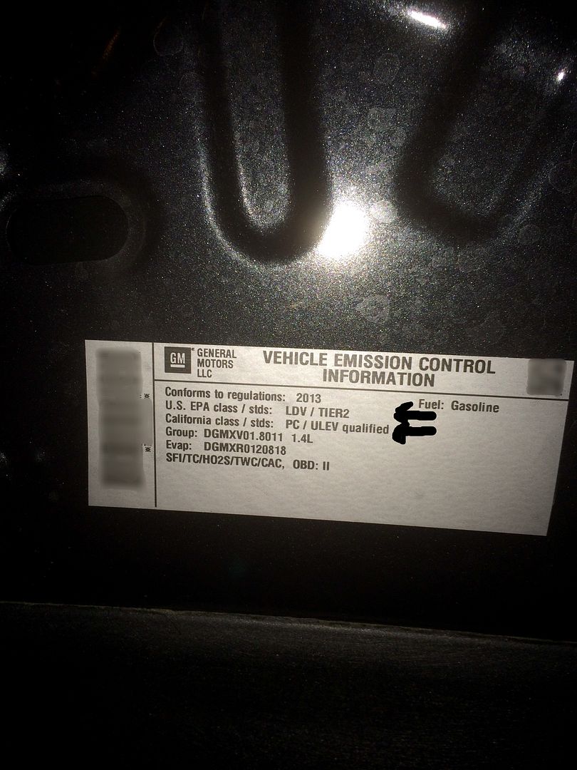

Is your vin 1G1PA56G or 1G1PA56H? Better yet, what does it say under the hood to the right near you right thumb if you were holding it open?

Injen makes a CAI for the 1.8L but you have to look up a 13 cruze 1.8L
So a K&N 69 Typhoon Cold air intake will work, but you will need a Vent Air Intake for the Air Injector as well. I'm doing the same thing with my 2014 Chevy Cruze LS 1.8L. Which another K&N Air filter to fit the Air Injector is about $30 on Amazon.
