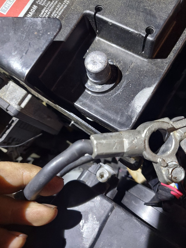

Be aware that Cruze battery cables are poorly made. A recall went out for the negative cables. Ours fritzed out and I found the wire was pulled out and bulged into a ball under the insulation. This picture shows what it looked like when it broke down suddenly for the bad negative cable. The short red one was also in very poor condition and replaced shortly after. The crimp at the alternator also sucked because it was loose and green with rampant corrosion inside the loose crimp. I ran a new ground from the engine to the battery and it caused errors. I had to relocate the extra grounds to the chassis post so that the current sensor isnt bypassed.
