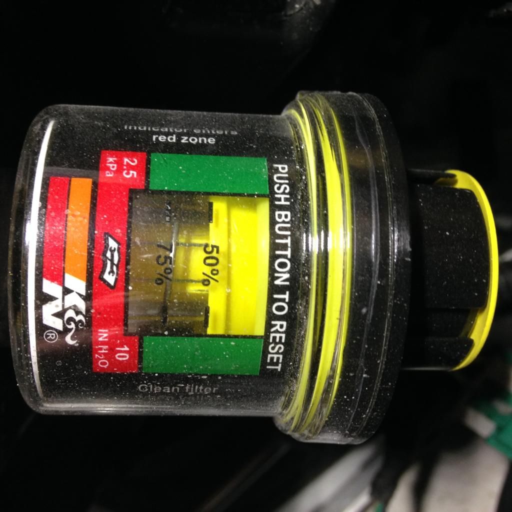

K+N, makers of high flow air filters (as most of you know) sells a filter monitor that recommends a filter change (or cleaning) when restriction gets to 10" H2O, much less than the 25" H2O commercial units. This makes sense since aftermarket performance intakes SHOULD flow better, and should be maintained that way.
Here's the 10" H2O monitor sold by K+N:
http://www.amazon.com/85-2445-Filte...bs_auto_2?ie=UTF8&refRID=0EBW63K4ECS7A8YXVR2E
And here it is installed on my air filter housing:
For the record, my intake is 100% completely stock. No tube delete, resonator still in place, everything exactly like it was when the car left the assembly plant... including the almost three year old air filter. Stock tune.
I drove around for a couple of days, making sure to do a few 2nd gear pulls to redline. I popped the hood and saw this:
Yep, a 1.4T with a stock intake and a three year old air filter is only showing 5" H2O vacuum, about HALF (50% on the monitor) of what K+N recommends as maximum restriction for a high flow after market intake system.
Like I said, I'm not debating whether an aftermarket intake flows more air, it absolutely does. I'm just pointing out that the stock intake flows much better than most people will give it credit for.
If I decide to modify my intake in the future I will provide updates as to whether anything changed for the better. Also, the fact that it's winter time may have an effect also. We'll see if warmer temperatures change things.

Looks like what the old factory silverado airbox has on it. Have reset more then I can think of lol. Nice writeup tho. And so is this on the factory paper filter?
Yeah, these are very common on trucks since they often operate in dirty environments and end up with plugged filters much sooner than the average car.
Yes, this is with the stock filter, untouched. It still has the foam "pre-filter" pad attached and has been filtering my engine's air since the spring of 2012. Mind you, I don't typically drive in dirty environments and my filter still looks pretty clean. It's nice to have this minder on there to know for sure it doesn't need changing.
Which brings up another good point. Even though this filter minder costs about $30, if it saves you the cost of changing filters prematurely it will likely pay for itself. I was planning to put a new filter in this spring but I'll hold off now... maybe I'll get 4-5 years out of this air filter?

Only problem with testing different filters with this is it would not really tell you anything useful. What I mean is we know a stock air filters filtration is far superior to a K&N, which means the K&N would always show less vacuum since its always less restrictive. K&N even claimed in the past their filters flowed more air dirty than a stock paper filter did brand new, can assume this claim could easily be seen with this installed.
Just remember this is only going to measure how restrictive the filter is, not how well it filters the air because of it.

There are TONS of things I would like to experiment with now that I have that gauge installed (I think I'll just refer to it as a vacuum gauge from now on). Bypassing the intake resonator for example... how effective is that really? Different filters? Pulling the foam prefilter? Maybe there's enough restriction in the resonator and snorkel that the filter choice doesn't make a difference unless they're bypassed?
I doubt I'll be investing in an aftermarket filter unless I see some reason to do so, but at least I'll have some sort of educated guess going into it now.
Update: I was under the hood the other day and noticed the vacuum gauge reading had climbed to between the 50% and 75% lines. Is this due to warmer weather? A rare moment of higher than normal airflow? I don't know yet, but I'll keep updating with any relevant findings.
