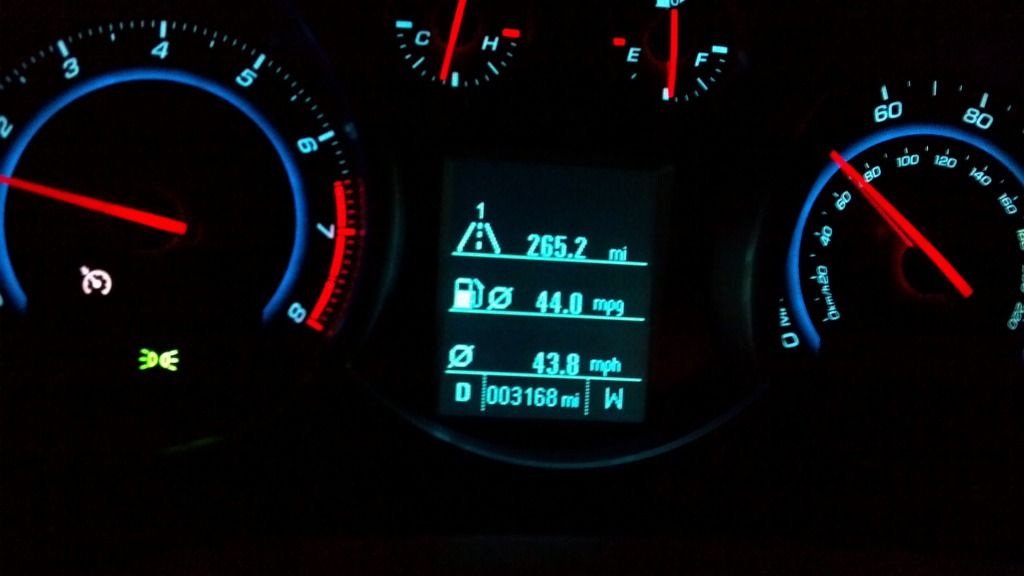

I ran 87 octane for the 1st 2000 miles, never heard or felt any ping or knock in the engine. X recommended me to try 91 octane non OXY fuel ($.46 more per gal Here), so i did, two takes and 850 miles. I also think the engine is breaking in but i got 40.4 mpg on way to and from work. I regapped the plugs, and swapped back to 10% ethanol and 87 octane and my DIC it still showing the same MPG as my last two tanks with 91 octane.
Here is a pic at 265 mile into the tank. 87 octane with 10% ethanol.
