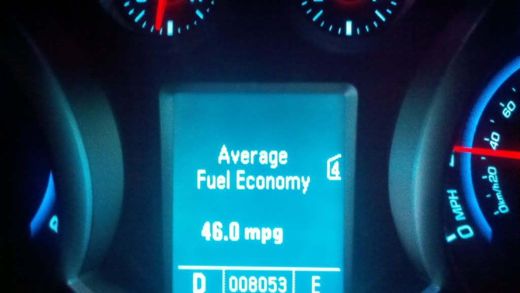

over the past month or so I have been experimenting with E85. I have been running my tank down till the low light comes on then I have been filling up with 3.0 gallons of E85 and then toping off with 91 (the highest octane available here). My results have been fairly consistent over the time period. I would like to note that i only try for good fuel mileage during the work week, my driving habits on the weekend include alot of idling and stopping and going, that being said i have not gotten below 31mpg on my weekend. My driving habits on the weekdays are 92% highway. On the highway i set cruise at 55-57 mph and then take it easy in the city. The picture below is right after a fill up, this is from my work week.
If i calculate the mileage with total amount of fuel it equals 45.4

...the DIC display is typically slightly "optimistic" because the ECM seems to slightly under-estimate total fuel (GALS) consumed.
...luckily both you and the DIC/ECM use the same milage (MILES) numbers from Trip#1 or Trip#2; although, measurements show even that number is slightly 'off' too:
...welcome to the 'fool economy' club!
...your GPS milage seems to be pretty accurate, because when Car & Driver did their Cruze LTZ tests, one of the measurements they made was: one OdoMile = 5,317 feet. That's 37 feet too long, indicating the odometer readings are 0.007% too high (1.0070 = 5317/5280), which matches up with your milage numbers (1.0050 = 1698/1689) pretty well.
...and your DIC/actual fuel ratio ( 0.94 = 54.5/58.2 ) is also very close to what I've been tracking ( ~0.95 ).
...thus, MILES are slightly high and GALS are slightly low, and cause the "optimistic" MPG values shown on the DIC display.
