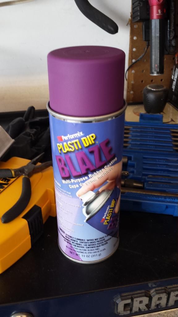

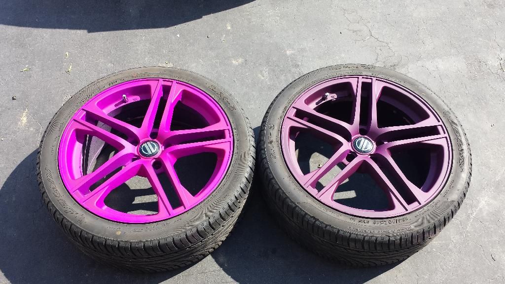

If you really want the bright "pop" you will you will NEED a white base coat. See in the pic there are two wheels sprayed with the same purple but two different outcomes. The darker wheel was with a black base coat. The lighter was with a white base coat. You can spray the white over the black until full coverage or just start from scratch. Hope this helps

I kinda like the color with the black base better than the white.

The other thing to remember, if you use Blaze, it will fade with time.
