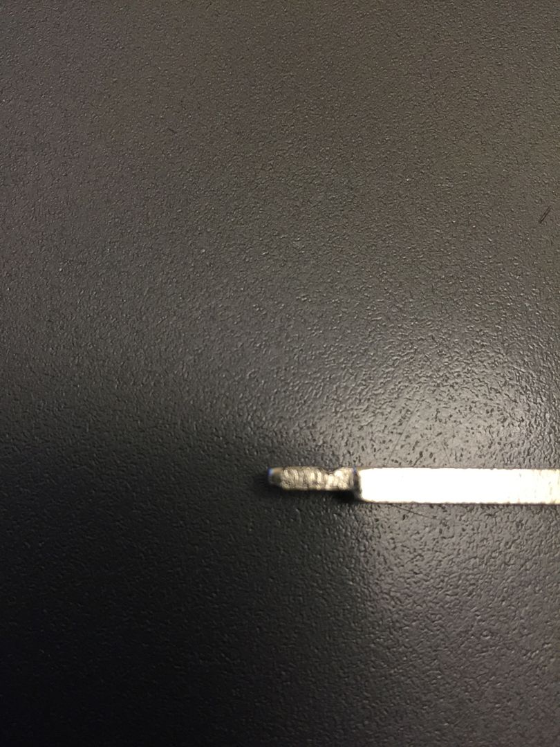

Good Evening,
I noticed my key fob is broken. It appears the key itself is fine just what held the key in place broke off. I had a friend who also said they had this issue before.....possible wear and tear mix with bad key design?
Anywho...
Im already certain to get a new one will cost probably $50+ of which right now I can't afford.
For the time being could I just get some glue to put it back in place?
If so what would be advised glue?
Thanks in advance.
The little roll pin that you see in your picture is what actually holds the cut key blank into the holder. It's actually a really small roll pin that's driven into the hole on the cut key blank, and into the key holder that you see in the picture above that is broke off.
When gluing it, be careful not to get glue on the actual cut key blank, because I'm guessing your cheapest solution would be to get any used keyfob that's the right frequency and move your key blank over to that fob. I believe the company that makes the key fobs had a video for a Camaro on you tube.

After going to PB and looking at the pic full size, The key blank actually looks like it could have survived that break.
jaye3rd89, does your key look like this?
Yes. Just one solid piece.
It looks like the key itself is fine its just the tiny slot on top broke off. So i assume glueing the broken piece back on top so the key properly sits in the slot would be a cheap fix.
