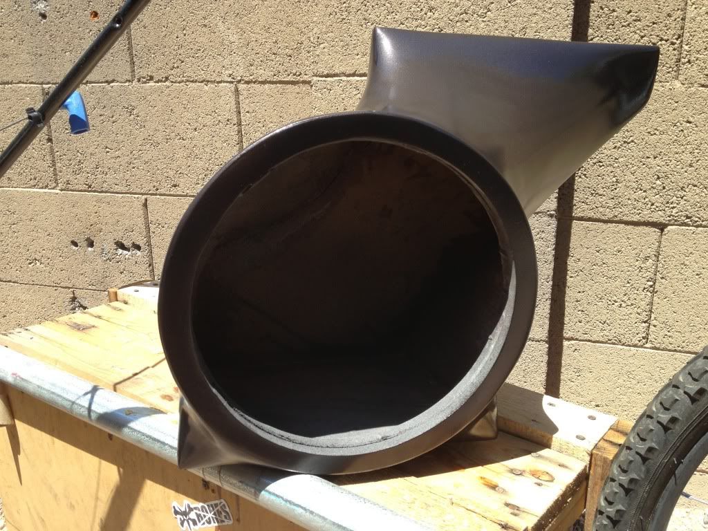

After a long delay, we are ready to start taking orders on fiberglass enclosures. These are built solid as a rock out of thick fiberglass by hand here in the USA. Nope, this isn't some Chinese crap. This is quality American craftsmanship, with great attention to detail, precision routing, and pride in workmanship.
Specifications:
Internal Volume: ~0.7 cubic feet
Maximum mounting depth: 6-3/4"
Subwoofer diameter: 8"-12"
NOTE: THIS DOES NOT FIT IN THE CRUZE DIESEL.
Each enclosure can be routed to the specifications of your subwoofer's cutout diameter.
Enclosures come in two finishes; either carpeted to match the trunk of your Cruze as shown in this 10" enclosure:
Or painted as shown in this 12" enclosure:

Can i ask what kind of 12' SQ subs would fit the enclosure in terms of mounting depth and sounding good... ID, TC, Morel etc.?
Thanks
Hari
You'll be looking for a low Qts in the T/S parameters. Very low in fact. In 0.7 cubic feet, I'm talking down to low 0.3x range, and into the the 0.2x range. This will require high motor strength and low moving mass as well as a light suspension.
Expect to spend a pretty penny and compromise some bottom end extension with a 12". Fiberglass fill may be required. The IDQ12 V3 would work here, but just barely. The IDQ12 V2 would be better. The IDQ10 V2 (not the V3) would be perfect. I happen to have one for sale.
