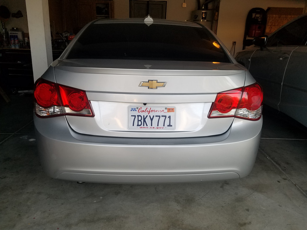

and done
Paint match was very close and install was a breeze. Its not taped down because I want to silicone the 4 holes on the lid...just bolted down for now but the tape is on the spoiler side

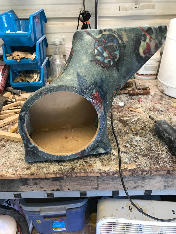

ordered a fiberglass sub box from intense autowerks, sundown E-10 and Audio Control LC2i from EMF car audio. Was hoping Andrei would build me one but I never heard from him so I'll give Intense a try. I already have KnuKoncepts power, speaker and RCA wiring....just need the hardware now.
