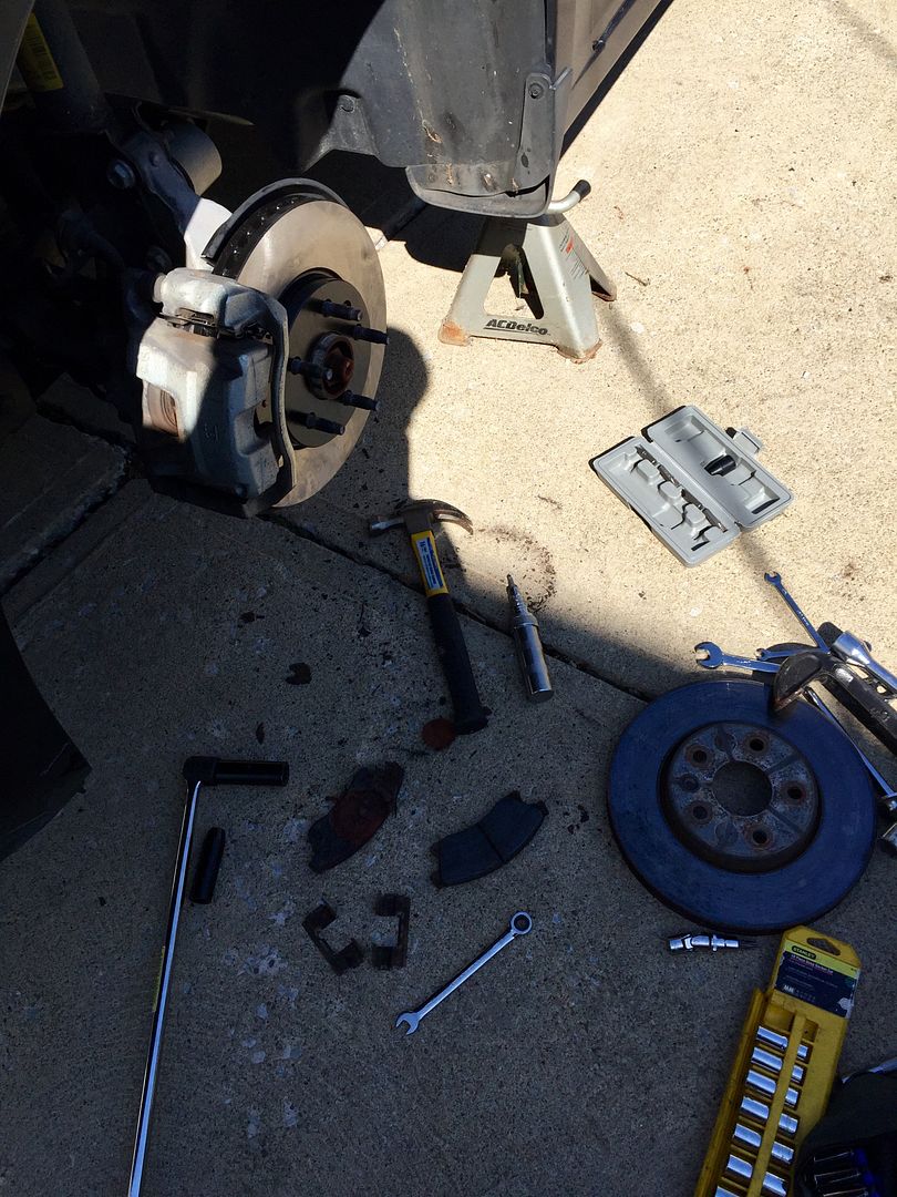

My originals only lasted about 200 miles.... I bought my 14 eco on a Tuesday evening, and on the following Saturday - I replaced the front brake pads with aftermarket ceramic pads. I prefer brake pads that don't immediately turn my rims black! I also took the opportunity to remove the retaining screw from the rotors and the drums. I believe those are to retain the component placement while its on the assembly line - and look like they could be a royal PITA to remove once corroded.
What kind of caliper is this? Sure doesn't look OE, looks like a good one. Torx is a four letter word.

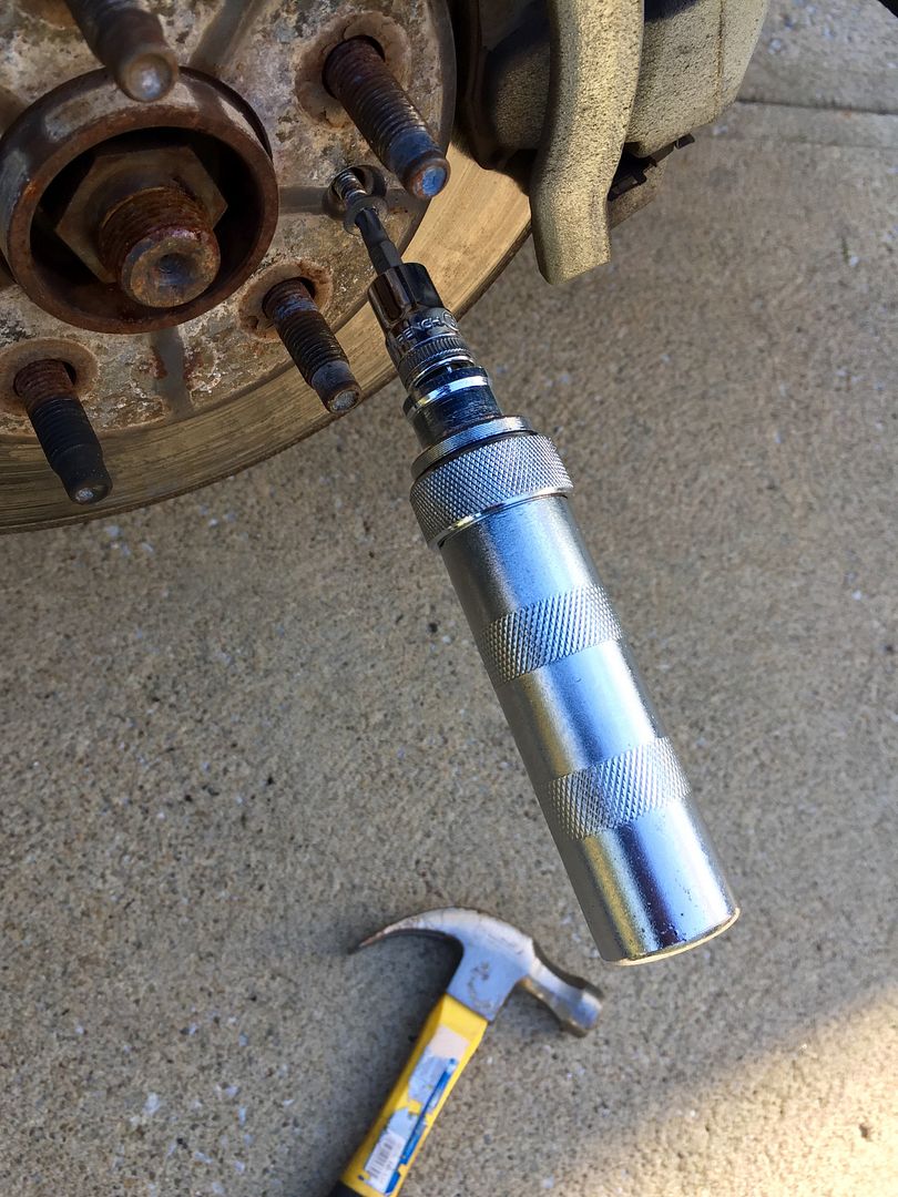

That's what they are for initially and this tool helps remove them. You hit with hammer and turn in the direction you wish it to go.
OEM calipers with Centric Premium Rotors and Power Stop Evolution Plus Z17 pads
Have a couple of those, by also have a Made in the USA impact wrench with an adjustment on it, can turn it down to zero, pull the trigger and slowly increase the pressure while putting a ton of axially force on it. Ratchets very slowly with light impacts to break it free. If I hit it with full force, bit will round out the inside of those Torx.
Okay for the rotors, but a heck of a lot of these Torx things you don't have a straight shot, so tend to put another four letter word in front of that four letter Torx word.
Took the liberty of blowing up your photo and made it brighter.
Ha, now it looks like OE, see you have some plating left on your pad holders, like I been saying, buying a brand new vehicle is like buying a lottery ticket. Are you feeling lucky? Mine are very brown colored, think they call this ferrous oxide and came from the factory unplated.
