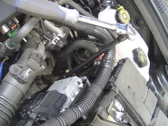

0. Break free the fill plug. If you cannot open the fill plug, STOP! Get a buddy or some more tools. If you can't open the fill plug, then re-filling the transmission will get much more difficult. Not impossible, just much more difficult. The transmission can be re-filled through the level plug if you're so inclined using a fluid transfer pump like a pump-type hand soap dispenser uses. I'd recommend against this, however.
The fill plug is the quarter-sized round thing with the hex head on it.
Use the 8mm" hex bit on the long extensions to break the fill plug free. It's on there pretty well, so it will need a bit of a heave-ho to get free.

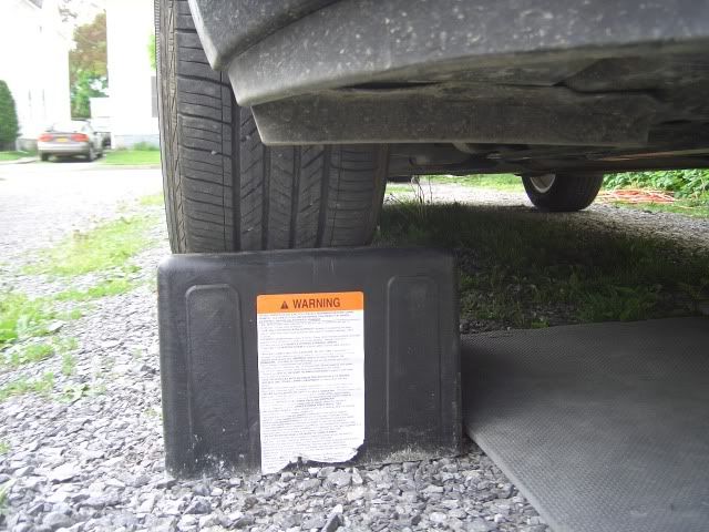

1. Get the car up in the air. I used my Rhino Ramps and drove up them.

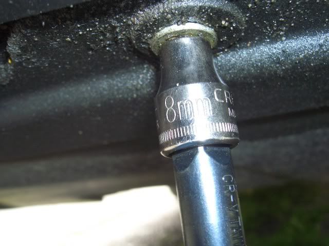

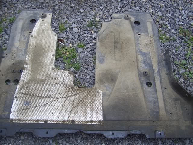

2. Detach the under-engine panel with the 8mm socket and the flat-bladed screwdriver. There are 6 8mm screws, 6 plastic pop-out connectors, and 2 other plastic pop connectors holding the panel on. 4 screws are located at the front of the panel, while the other two are located at the back, one on each side of the oil pan cutout. There are 3 pop-out connectors on each side. One holds on the little airdam in front of the front tires. The other two attach the under-engine panel to the fenderwell skirts. Remove these and set them with the screws.
Note the two raised screw holes at the back of the panel.
If your Cruze has had the shield recall done, your shield will not look like this. Per feedback from other folks, removing the remaining shield is not needed.

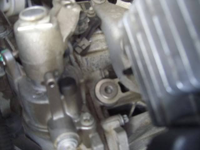

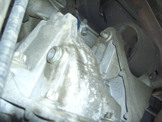

3. Locate the level port. It's on the side pan of the transmission. (NOTE: This was deleted on the later 2012 and 2013+ Cruzes. Ignore this step if you have a later Cruze.)
Use the 10mm hex socket on a short extension to take it out.

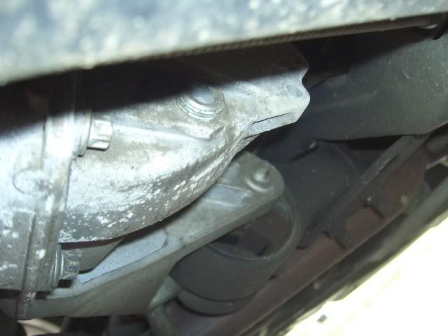

4. Locate the drain port. It's underneath the differential housing, next to the subframe.

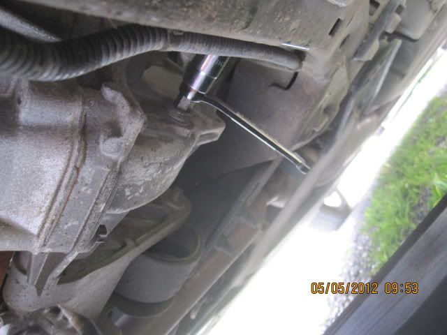

Another view:
Here's the tool I cobbled together to undo the drain plug. It's the 10mm hex socket with the box end of the 10mm wrench slid over the socket. A ratchet does not have enough room to clear the subframe.

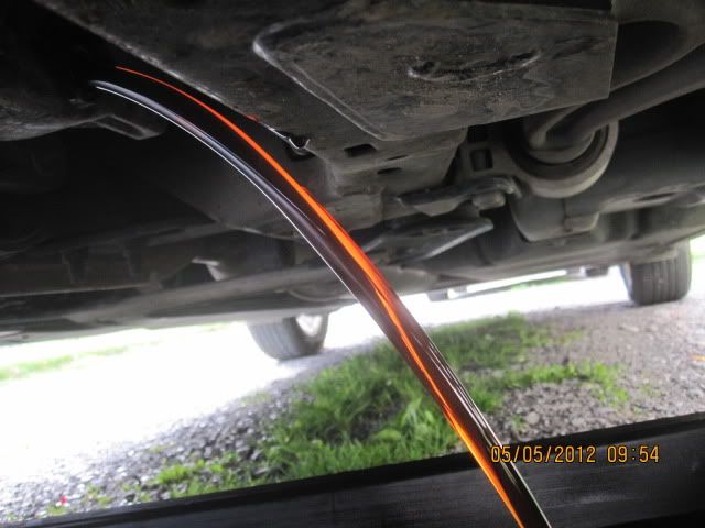

5. Make sure your drain pan is a foot to the right of the drain plug, as the fluid will shoot out in a glorious jet almost to the tire.
6. Give the drain plug a good heave-ho, as it's on there pretty well.
7. Adjust the drain pan as needed to catch the fluid.
8. Let the fluid drain.
