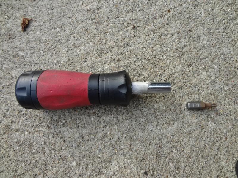

Screwdriver
T20 Bit

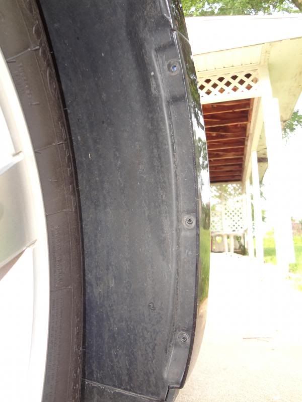

Turn your wheels to the opposite side you will be working on, allowing room to access three screws.
Step 2:
Remove said screws.

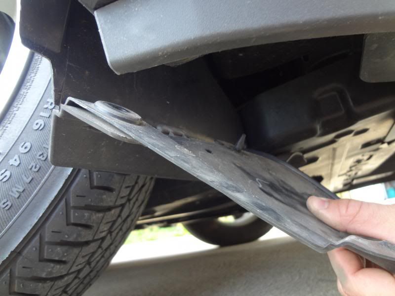

Next, look under the vehicle, directly under the plastic fender well you removed the 3 screws from, in front of the tire and locate the small "aero panel" and remove both screws from it.
Step 4:
You are now able to pull the fender well back a little bit, enough that you can reach in and press the clip to release the lense.

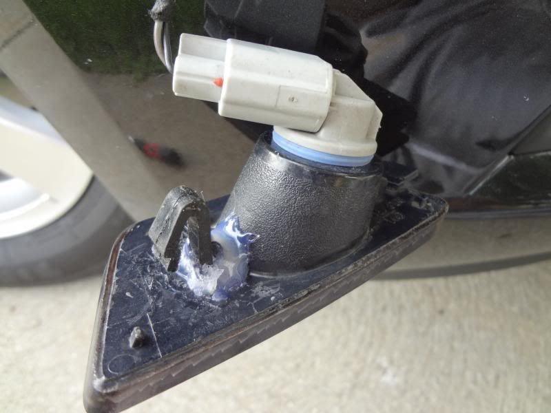

Can see on your one photo, already had to hot glue in those broken tabs.
Yup, but that's because I bought them with that one broken tab, got a great deal!

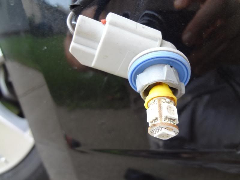

Is the stock bulb amber in color or just the lens? I have smoked lenses just wanna know if have to replace the light as well. Thanks bro
Its not even necessary to remove the screws under the front bumper. Its possible to save 5 minutes and just remove the 3 screws from the fender well and reach in to release the lense.
The stock bulb is your standard white. It's the lense that makes it Amber in color, that's why I have the Amber LED's.
