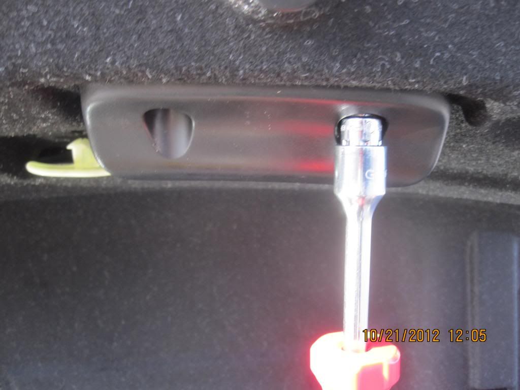

First, remove the 7mm bolts holding on the trunk handle:

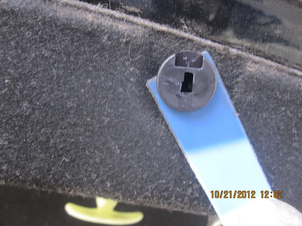

Next, start popping off the body panel clips holding the trunk liner on:

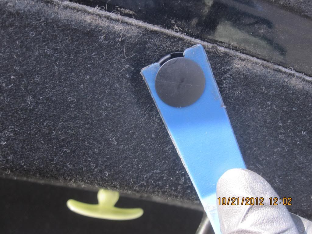

I found it easy to use a set of body panel tools to first pop off the center locking pin, then dig under the body of the clip like so:

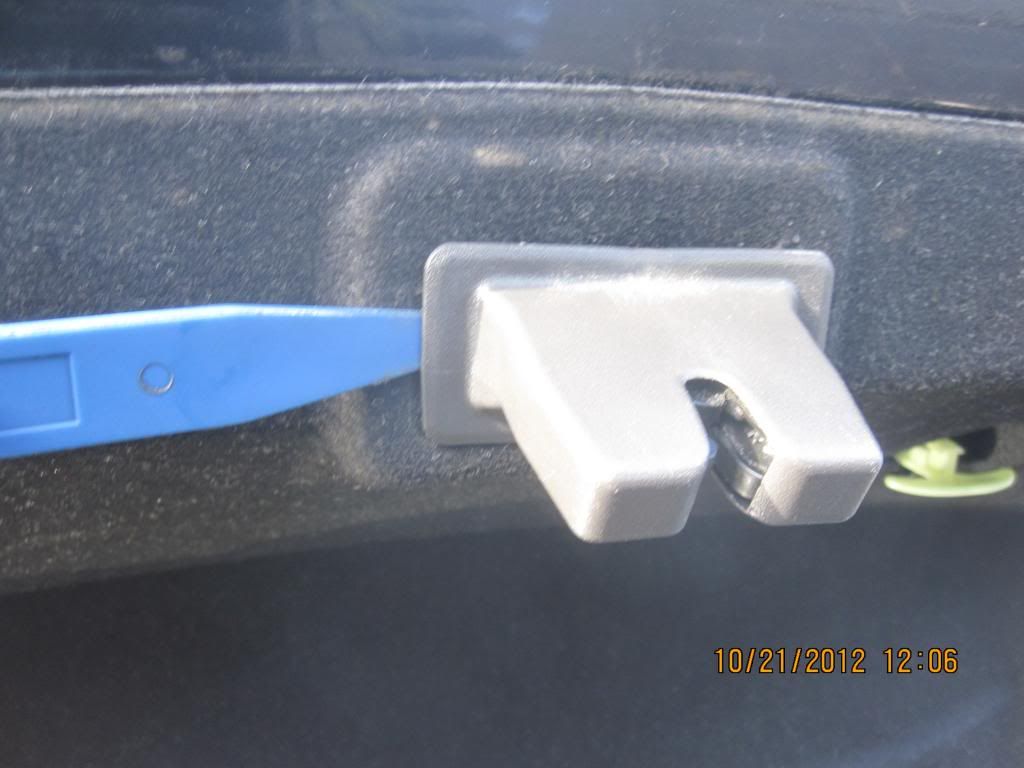

Then, pop off the plastic latch cover:
Push in and twist with the tool. It should come right out with some persuasion.
There are about 15 clips that need to be removed. Most of them are visible and easy to get to:

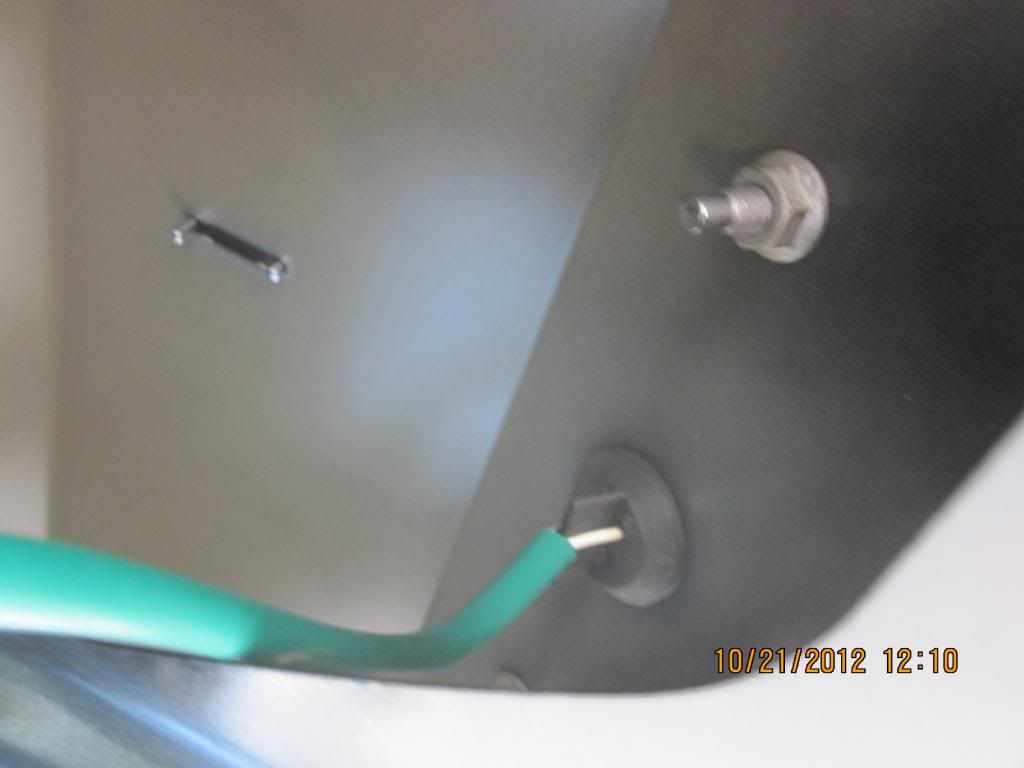

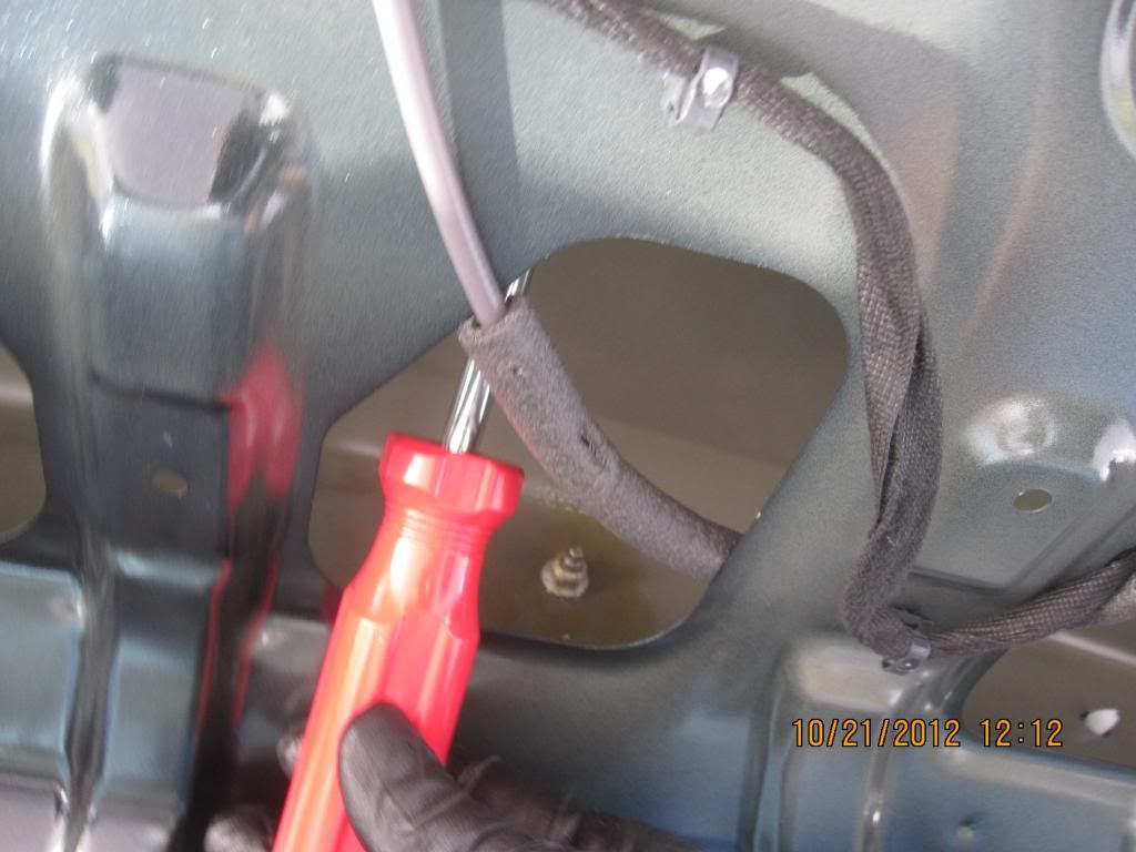

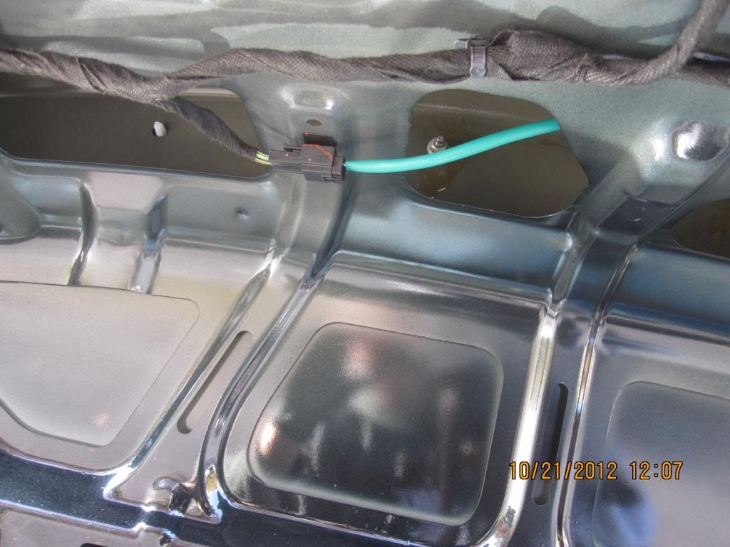

The green wire loom is the one that leads to the trunk switch. Disconnect it using the quick-disconnect:
The green wire loom terminates into a grommet. Push this out:

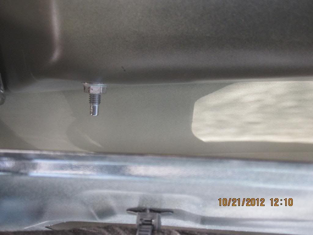

Locate the 4 10mm nuts holding the trunk switch into the trunk. They are easy to locate. Two are located next to the grommet that was pushed out earlier:
Two more are located further outboard, slightly hidden by the bodywork:
Remove the nuts with an extension as needed:

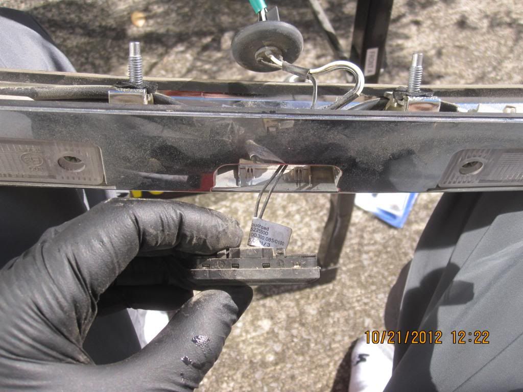

Wiggle the trunk switch out gently:

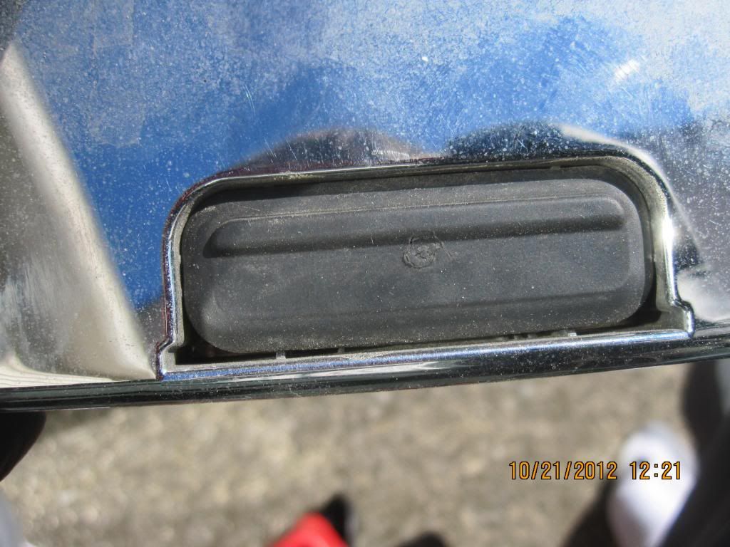

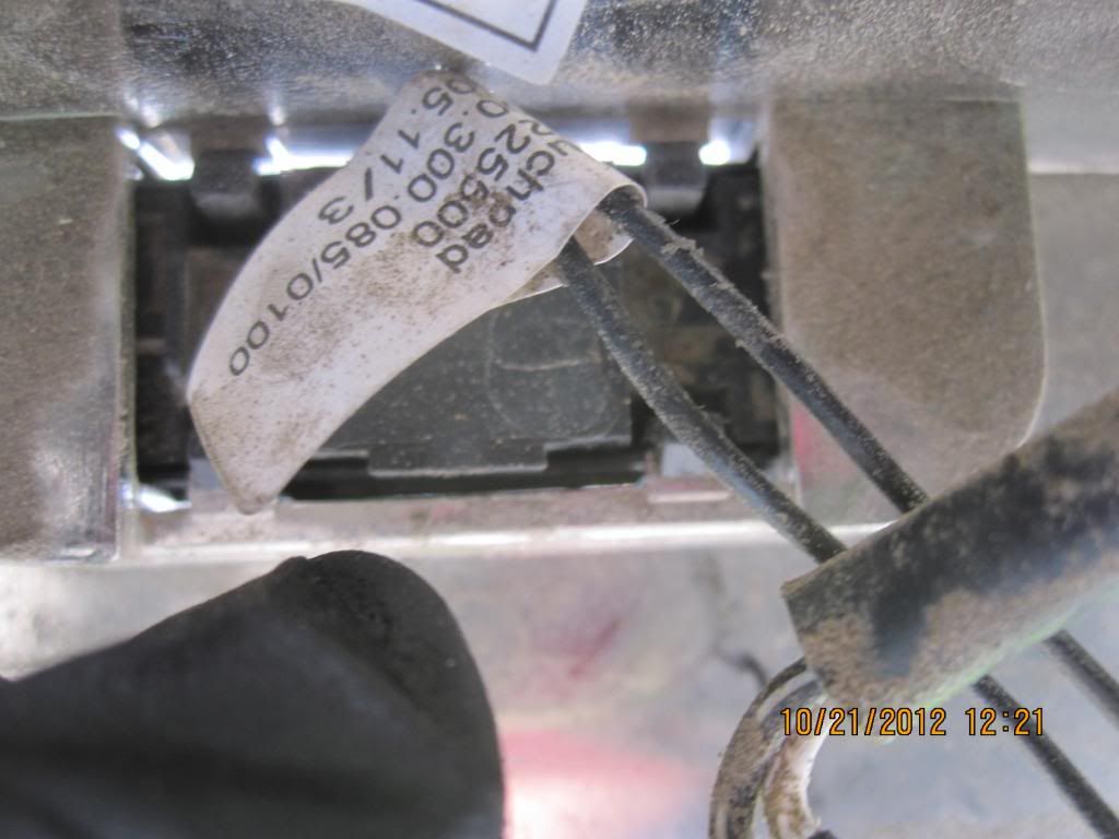

The trunk switch itself is not sealed very well, as we can see:
Our goal is to clean out and seal up the switch.

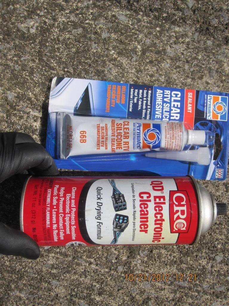

These are the products I used to get this done:

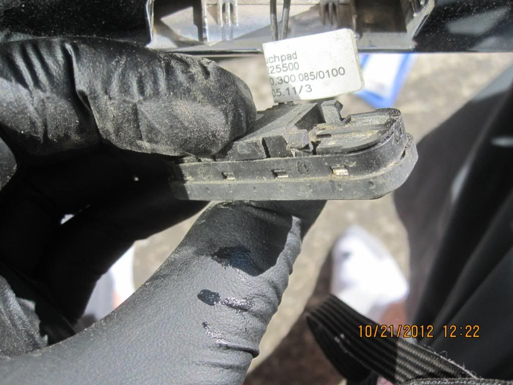

To clean the switch, pop it out gently with a small flat-blade screwdriver. No picture here.
Switch out:
Dirt can fall into the switch and collect, ruining the switch:
Now that the switch is out, liberally spray it with the electronics cleaner. Get it sloshing in there, dump it out, and spray more. Click the switch a bunch of times to work it into the contacts. Let the switch dry for a few minutes while taking a beverage break.

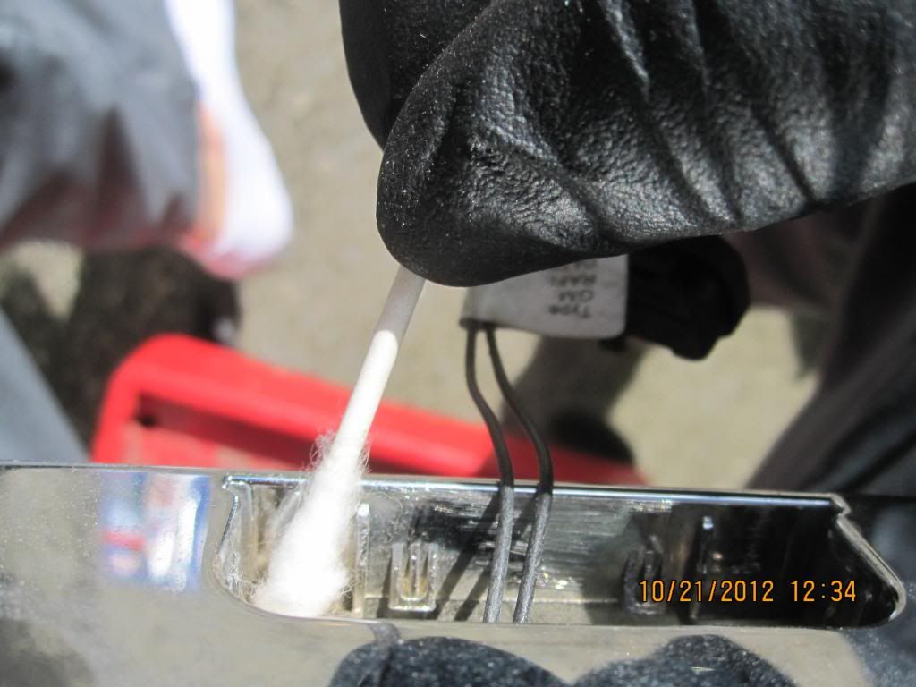

Next, scuff the inside of the switch holder to give the RTV silicone something to grip to. Clean it out with a Q-tip:

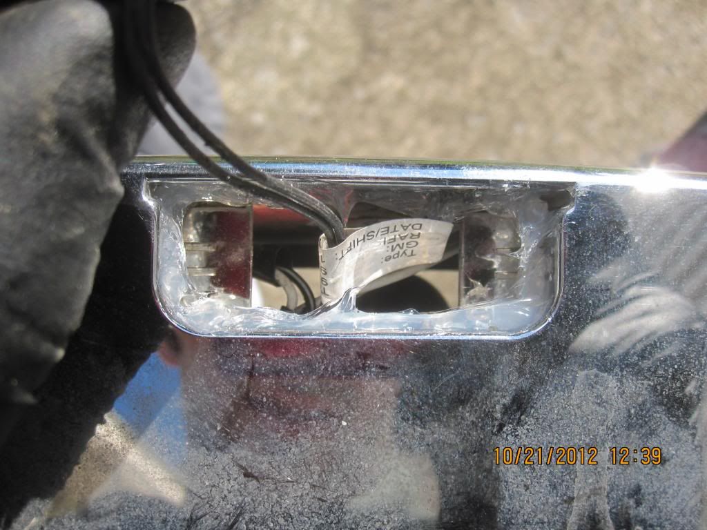

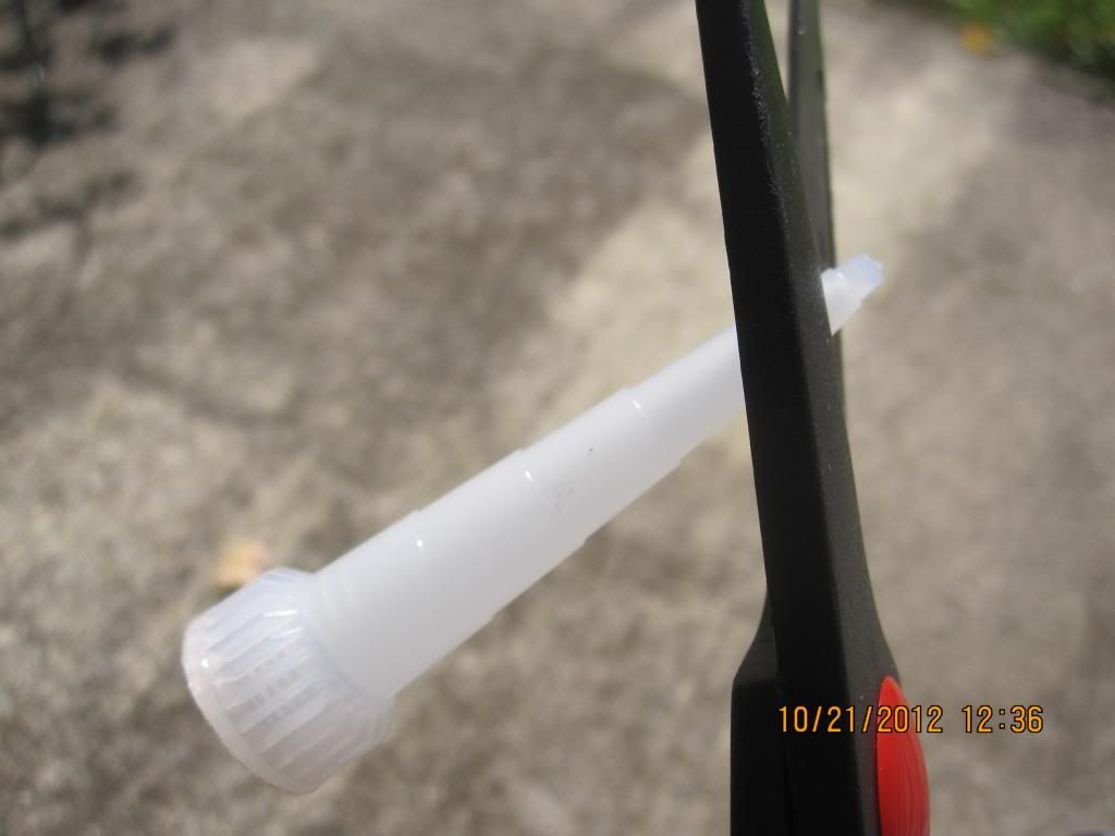

Cut the tip of the RTV silicone small, and apply a bead around the outside of the switch holding area:
Make especially sure to get lots of sealant into the corners!!!
After applying the silicone sealant, push the switch into place and spread more sealant around the outside:
Make sure there are few bubbles or non-filled areas.
I put a glob of sealant over the wires on the inside to deflect any water on the wires from running into the switch. I elected not to seal the switch completely to make any eventual removal easier.
Lastly, use a clean Q-tip to clean up any excess RTV silicone on the outside of the switch area for a clean finish:
Let the RTV dry for a few hours, and then commence re-assembly by following the directions for dis-assembly backwards. The switch should be far more functional now.
