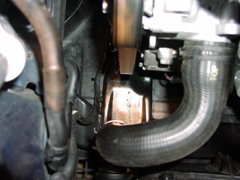

I've been smelling coolant after shutting down the car and it seems to be coming from under the hood. Funny thing is I haven't had to add much coolant - only about 1/2 gallon in 30k miles. I found a little spray pattern on the subframe near the serpentine belt and wiped it off. It came back after only a short while. Here is a picture but the reflection makes it hard to see. The pattern has a gap where the belt lines up with most of the spray on the inboard side.

Yep, sure looks like it!
Yep. 1/2 gallon of coolant in 30K miles is a lot.
I took my car to the dealer and told them I thought the water pump was leaking and mentioned the spray pattern near the belt. The tech said it showed up as dye from the A/C compressor and they replaced it yesterday. I'm not sure they're right because I still smell coolant but I guess the UV dye must be easy to check with a black light so we'll see.

One solid rocket booster does more damage to the ozone than all the R-12 in vehicles, but it still was proven to destroy ozone in a laboratory so who gets the shaft. CO2 A/C systems will be high pressure making it dangerous to work on. As to the OP I can tell you that coolant tends to glow just like A/C dye and you should never have to add coolant. You have a coolant leak.
