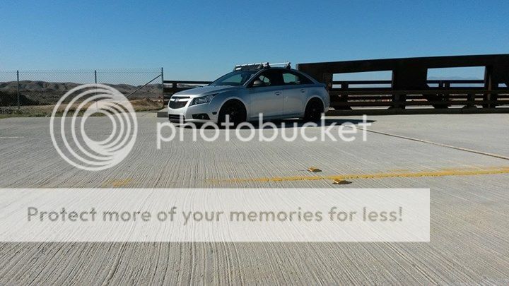

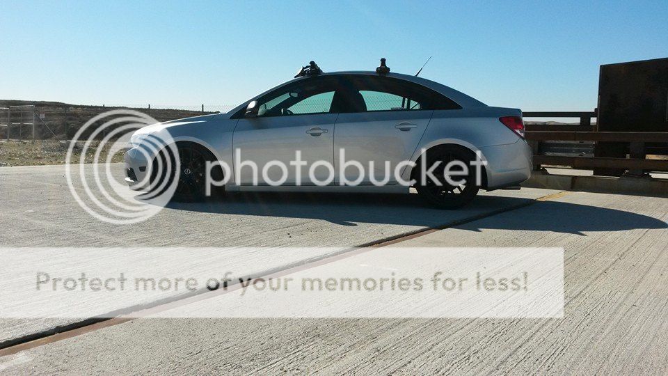

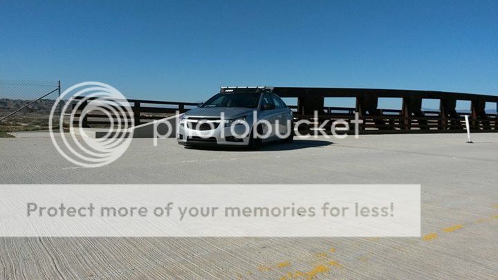

After having my Cruze riding at stock height for way too long now, I finally bought KSport Coilovers, and last night I finished the install. In order to get the rear as low as it is I had to take the silver adjustment rings off the machined bump stop spacer, and I had to camber the front wheels with the top knuckle/spindle mount in order to prevent rubbing on the fender while turning/taking a corner.
Anyways, enough of my jibber jabber, here are the results:
After install all I can say is, ride quality is nothing like I imagined it would be. I've heard continuously that coilovers will destroy your ride quality and make it so stiff that it becomes unbearable, but I actually like the new ride. Although it is indeed stiffer than stock, its still extremely comfortable, and I absolutely love how it rides right now. All I need to do is adjust my front set up a bit, and remove my wheel well covers so I don't rub as much over big bumps on the road.

Passenger side is fine, Driver side just needs to have the knuckle mount camber adjusted. I left one cambered and one stock to see if I needed it or not. Drove it around today and I don't rub on the passenger side at all, but I do on the driver's side, so once I camber adjust it will be perfect, and I'm just going to remove the covers to be safe.
850 Posts
I hear removing the liners won't get you much, and exposes some screws. Might be better off leaving them in.
If you get a chance to take some more pictures, take them with the side in the sun instead of shadow. Its hard to tell what it looks like...

It gives me a little more clearance, and if it does expose screws or anything sharp I'll either put the liners back or trim the objects down so I don't pop my tire.

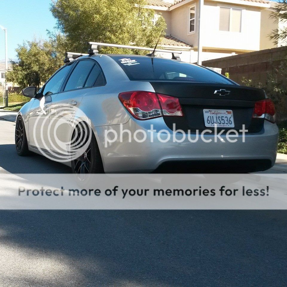

18x8.5 +40 with a 3/16" spacer on the read wheels, and a 235/45/18 tire. I have since raised the front end by about an inch and uncambered the wheels since with the tire I was running I was cutting through my tirewall with my own coilovers. I've also pulled my fender wells, and im working on flattening the inner fender to put my front spacers back on for added room between the tire and coilovers.
Next step is to buy new tires in a couple months since im already getting low on tread, and then I can get a smaller tire to drop the front end back down.

Do the K-Sports use a standard size spring? If so, you could probably buy a slightly shorter spring which would allow for a higher spring perch position for a given ride height. Assuming of course that the spring perch is what's interfering with the tire.
On the rear, was it necessary to roll the fenders before installing the spacers?
Do you have any close-up shots of your tire-to-fender clearance? It's always tough to see detail in whole car shots.
