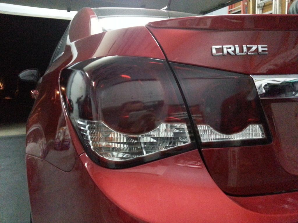

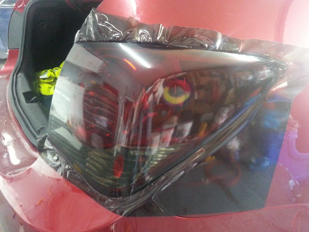

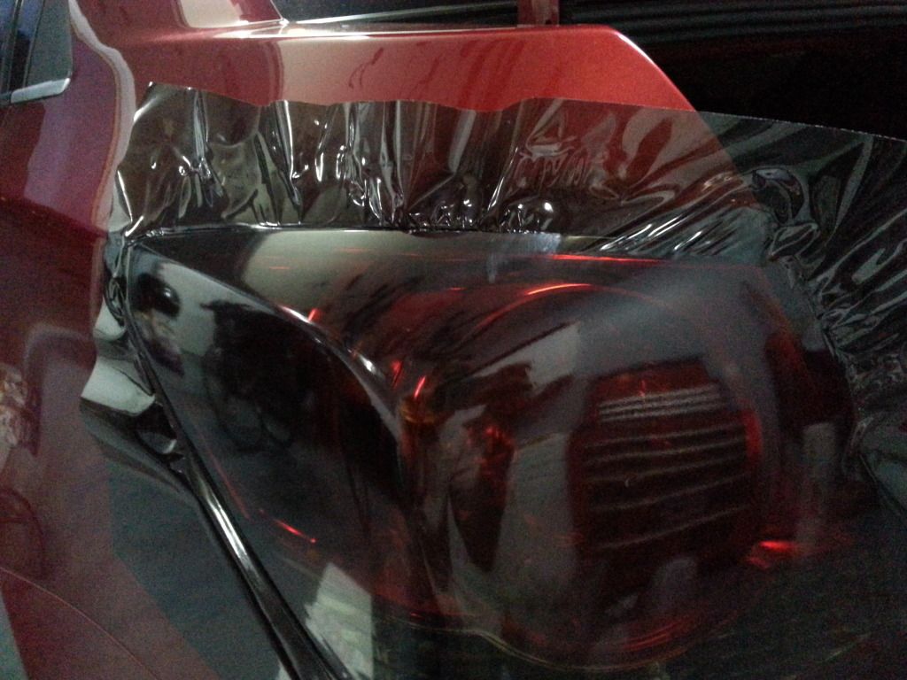

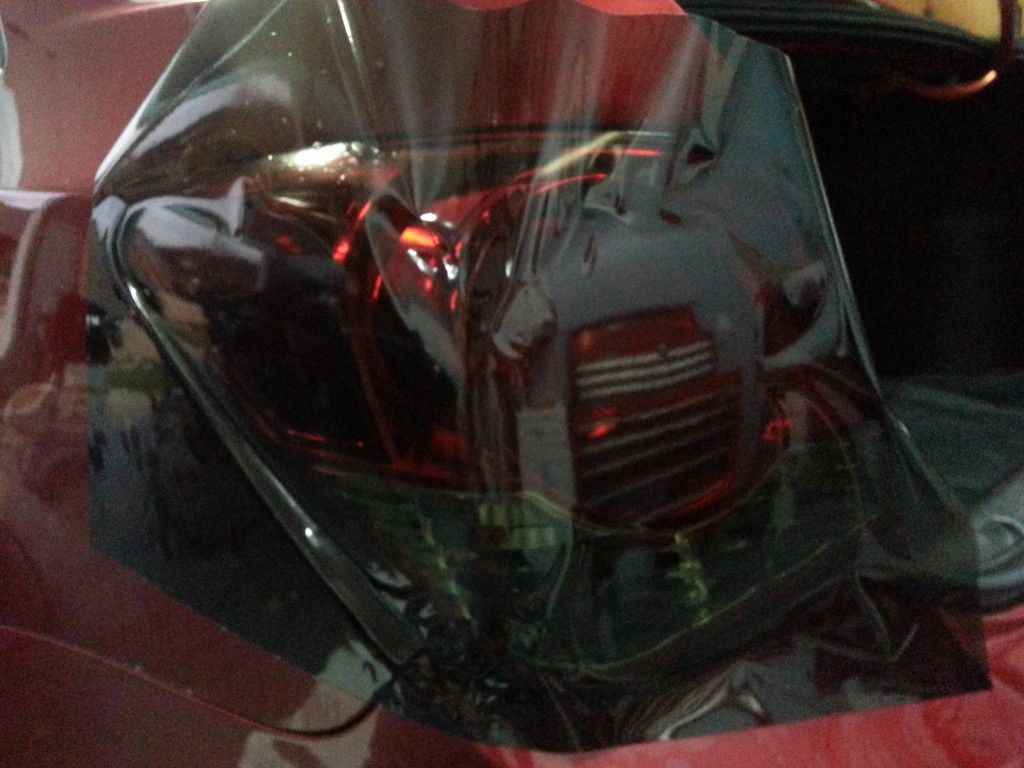

as for things you can take a look at now, I tinted the taillights with oracal 8300 dark grey vinyl. As I was working it occurred to me I am on window tint and so on groups and forums.... I see how this is done quite often but you all may not so I took some pictures of what the process/progress of applying such a film looks like. Not exactly the easiest thing to do but the results are awesome

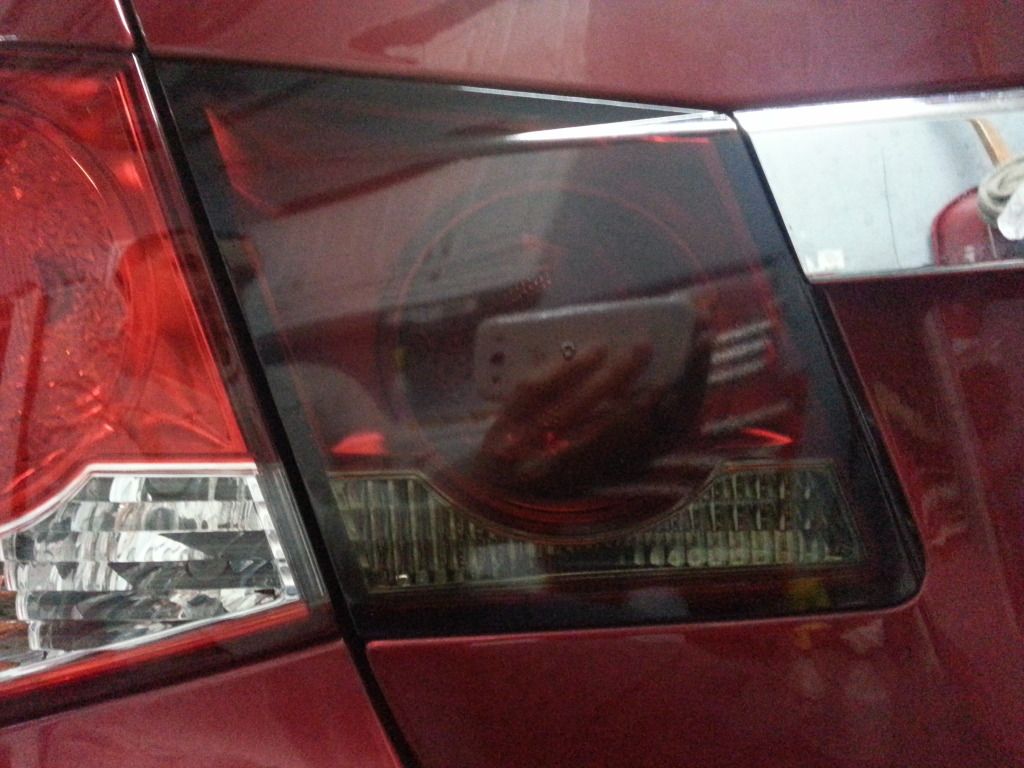

Started with the lid lights, done
and the the other with the white trimmed out (makes the white whiter and the black really pop)
(sorry about the water drops, should have wiped it off first)
Then the crazy corners
Other corner the following morning
and all together

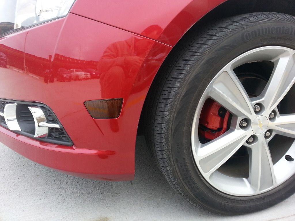

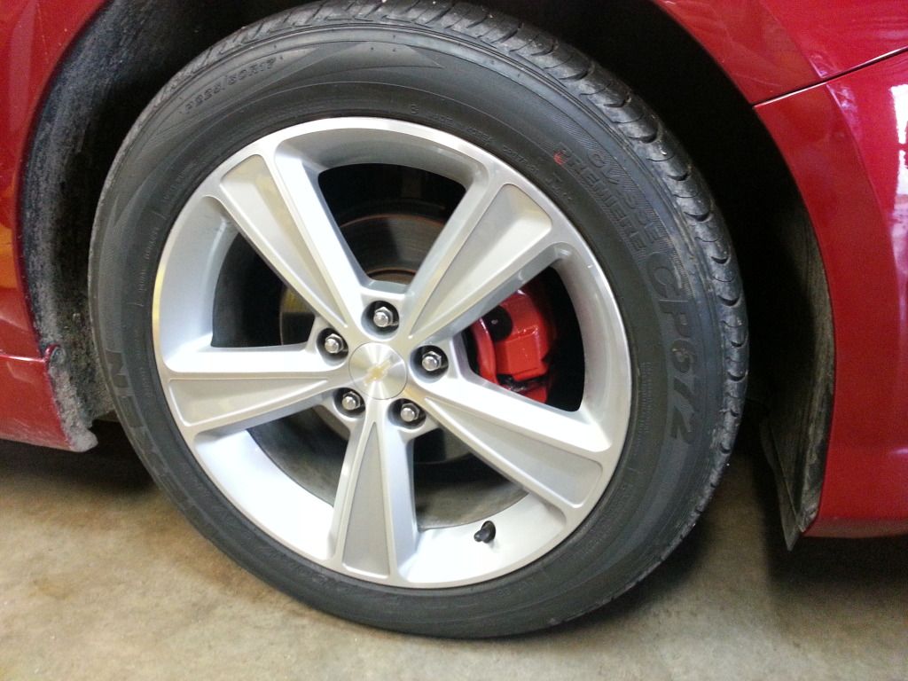

also knocked out the calipers and tinted the front side markers as well

I assume you cut the tint while on the tails based on the pictures taken. What did you use to cut them out? And do you have any remaining cuts in the surface of the lense as a result?
10,713 Posts
You can run your fingernail over the clear/red plastic parts so there isn't need to cut deeper than that ridge.
144 Posts
About an hour per corner and 30 min a piece for the lids. Front markers were 5 minutes a piece.
My uncle took care of the calipers while I tinted a car of his
as for cutting out the reverse lights I used an olfa knife. Just enough pressure to cut the film. IF there are cut marks they are small and right on the border between white and red. Not too concerned about it.
144 Posts
I think not just because you need them held in place while you pull and stretch the vinyl and apply the pressure to adhere it in place
2,806 Posts
For the sides did you start on the rear facing side, then stretch around to the side of the car, and finally the top; or side first, then rear, then top?
Just trying to figure out what the best way to approach doing this since I like the look so much I'll be ordering the film soon.

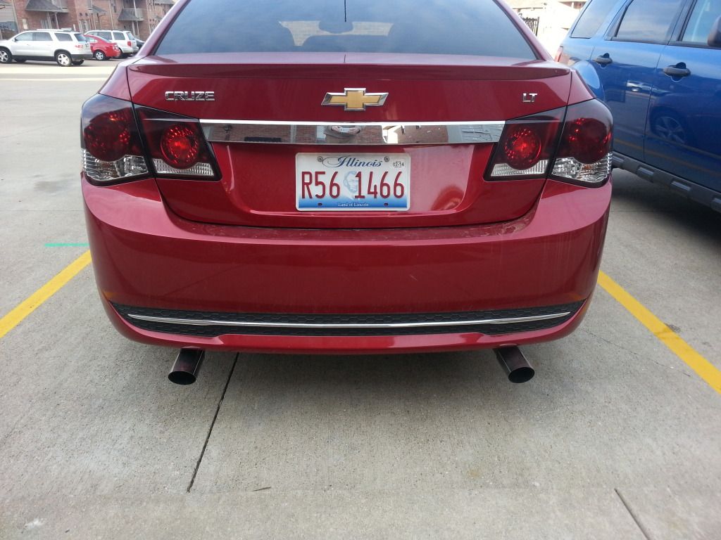

Looks amazing...
But those exhaust tips... anyway to cut and put wider tips or hide em

I started on the side, anchored it and wrapped to the back. Then worked from the corner up and out and then down. It is not really a DIY project, working this film takes patience and practice but if you need help let me know.
tips idk... They don't look to awful in person and actually sound really good.... But I havnt had much time with the car yet, it's been go go go since I got it between tinting and storm work restoring power in Washington IL
