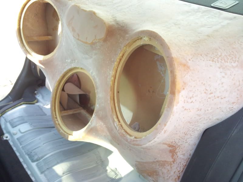

Decided to add some bass to the car and wanted something that looks better than a bland box in the trunk...I also like to use my trunk. So I've decided to remove my back seats (also prevents me from being the carpool car) and replace it with a box. I've been working on it on my off days for a total of about 3 days. The plan is 3 12"s and a 3500w amp. I'll keep taking pictures of the progress until it's complete. Should be pretty loud. Not really interested in being the loudest thing around but I really didn't want the back seats anymore.
And as of today it's covered in a few layers of fiberglass. Still needs more before it's strong enough.
Covered in fiberglass shavings from cutting the rings out.

OK added some pictures. Was too lazy to put it in the car because it looked like rain and was really windy blowing dirt in my face. So here's what I do have. It's coated in fiberglass and a mix of that and bondo on the inside to strengthen a little. Maybe a couple more coats then it'll be ready to sand and the body work.

OK so finally put it in the car for fitment and everything's good. Some slight gaps around the curves against the side cushions but easilly fillable. Then cut the back out to re-enforce the inside walls easier. Next will be to make the rest of the box mounting to the back for more air space that will protrude into the trunk a few inches. Then it will be down to bondo, sanding, and painting. Still need to make the bottom piece for the amp and battery.
