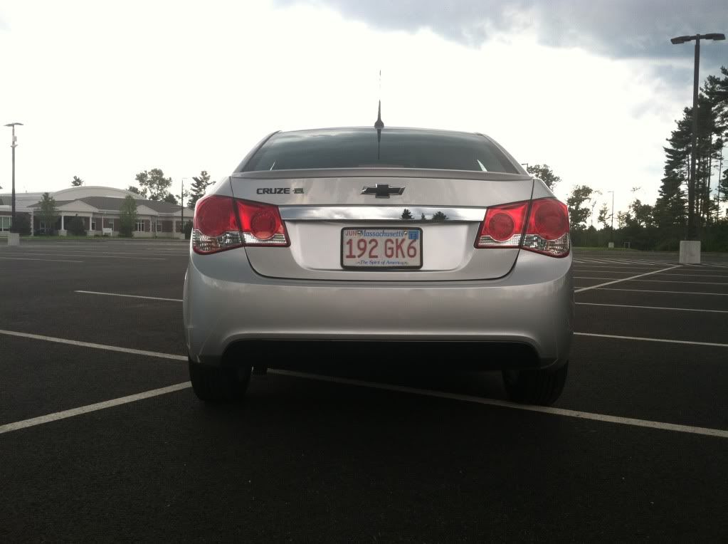

I just did my emblems and lettering with 5 coats of black plastidip, and 2 coats of glossifier and had no issues peeling off afterwards, but I've never used plastidip before so I can't tell you if it was easier or harder to pull off with glossifier or not just that I had no issues.
