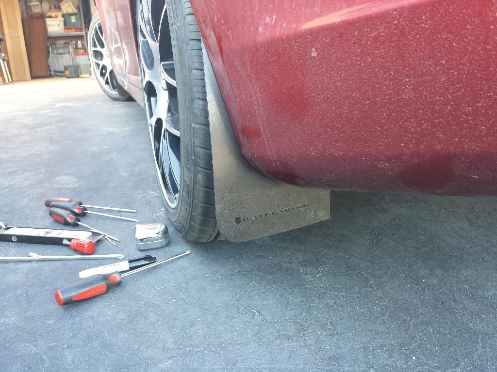

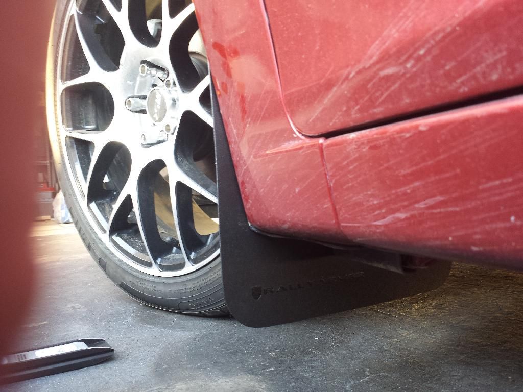

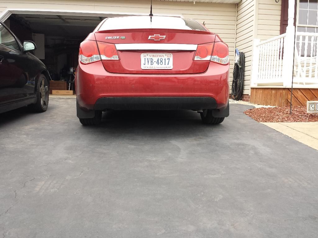

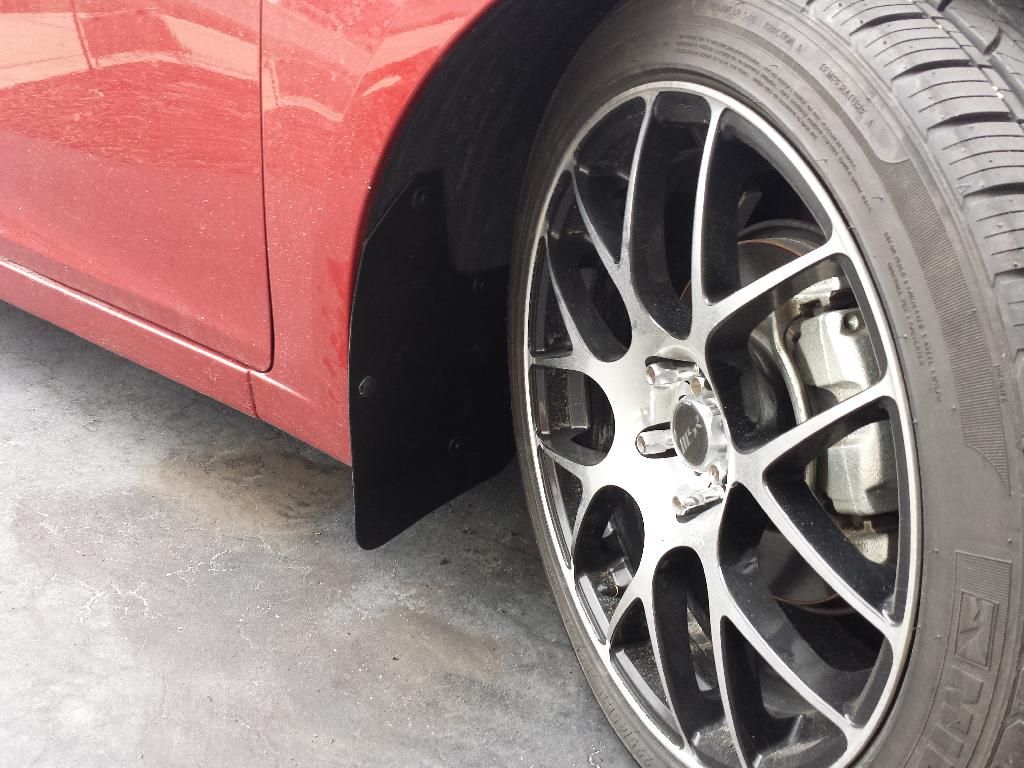

Sorry for the dirty car lol. Will have to get some clean pics of it tomorrow. The mud on it was there before install. Now they are on there I don't get any. As for install I used the factory plastic push rivets in the front and added another 3 rivets to each. The rear I used the factory screw on top and a longer screw with some spacers for the lower then added a plastic push pin on the inside. They done budge. The rear I cut down to fit along the factory plastic then the width of the tire and front just cut about an inch off. Pretty much once i got the drivers side set i used them to drill holes and cut the passenger side. Didn't really want them sticking way out at wanna be rally status but enough to be effective. Like I said I like them. Got mine from tirerack for about $26 shipped. Worth every penny. Can get better pics of mounting tomorrow if interested
