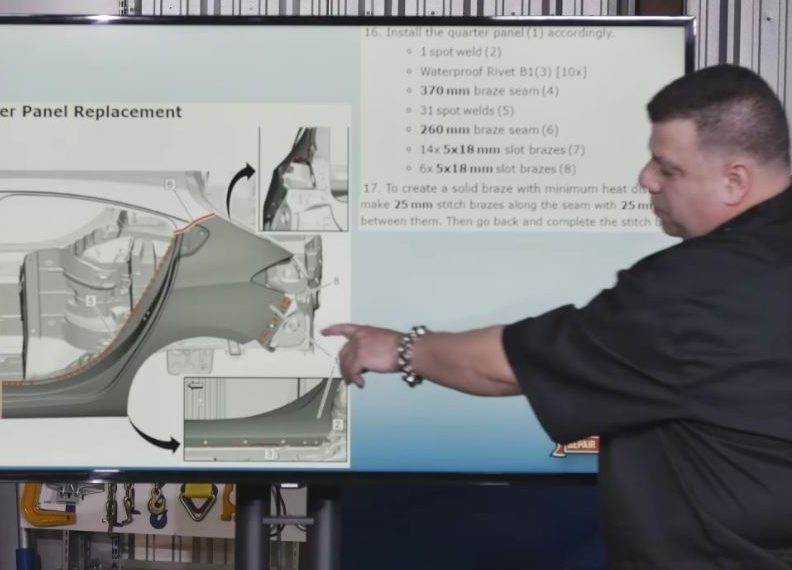

Way too much work just to fix a couple/three rust spots. If it were a fender, maybe. A quarter panel is major surgery, all you need is a bit of first aid.
But if that is what you want to do:
