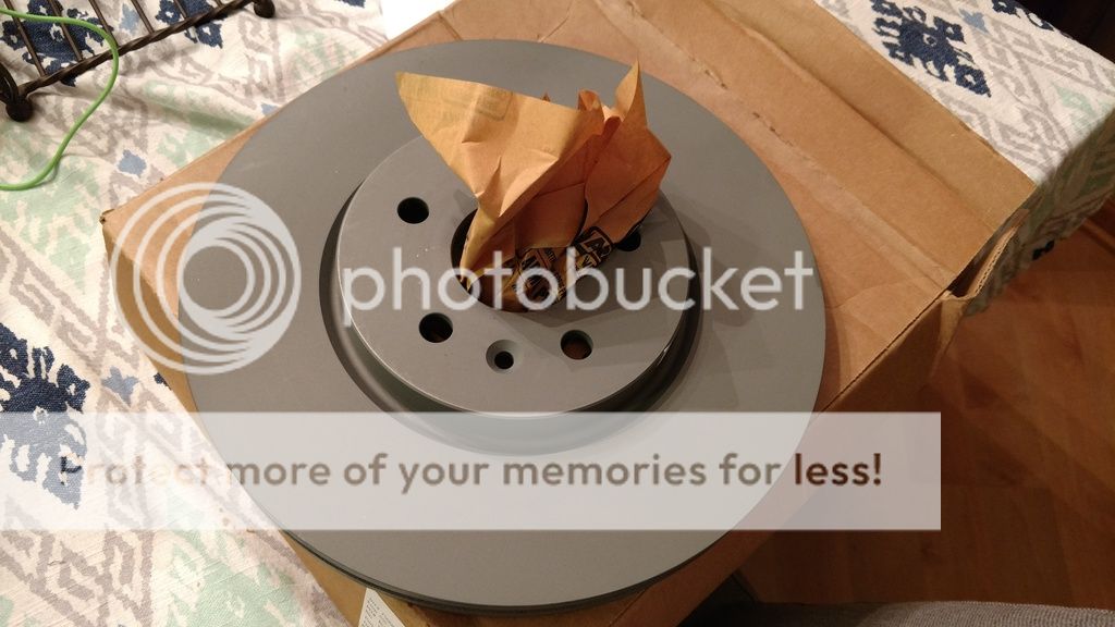

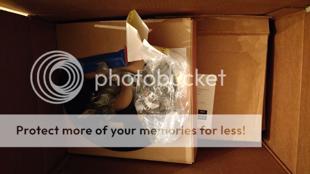

Thanks to GM Parts Direct and their inability to let you know when something is backordered I am just now getting brake parts. I have the rotors, pads, dust shields, bolts, drill bit, and 32mm socket. I am just waiting on the caliper carriers, they are backordered across the nation, but luckily I found someone that had them.

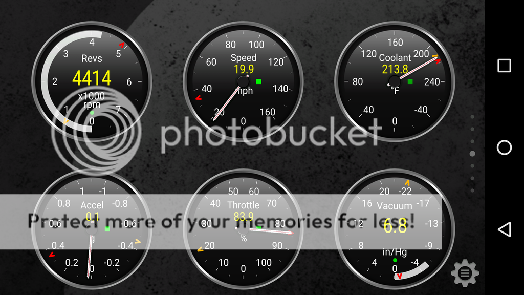

Discussion Starter · #66 · (Edited)

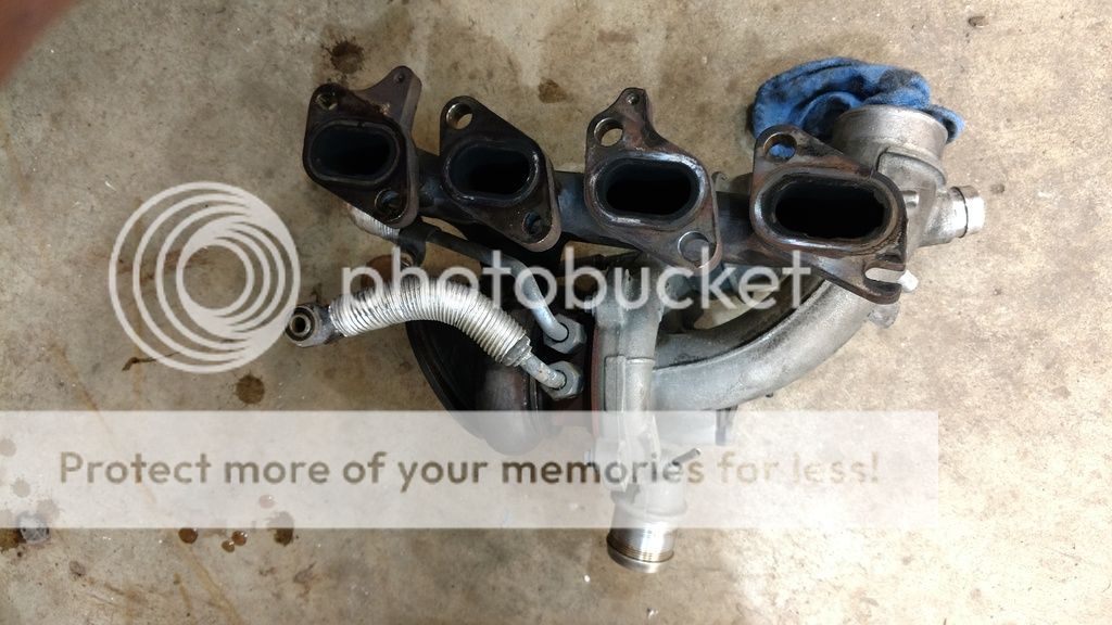

Alright here we are 3 months later and I was finally able to install my turbo. Then un-install the new one. Then re-install the old one.
As I said I found the perfect candidate for the turbo swap, one from a wrecked Buick with only 400 miles on it. The inspection went great, everything looked good except for the actuator had a dent in it and the vacuum nipple at the inlet was bent a little. I chalked it up to the radiator hitting them when the previous car was hit.
Fast forward to Friday night. I get in there and pull the car apart in a couple of hours.

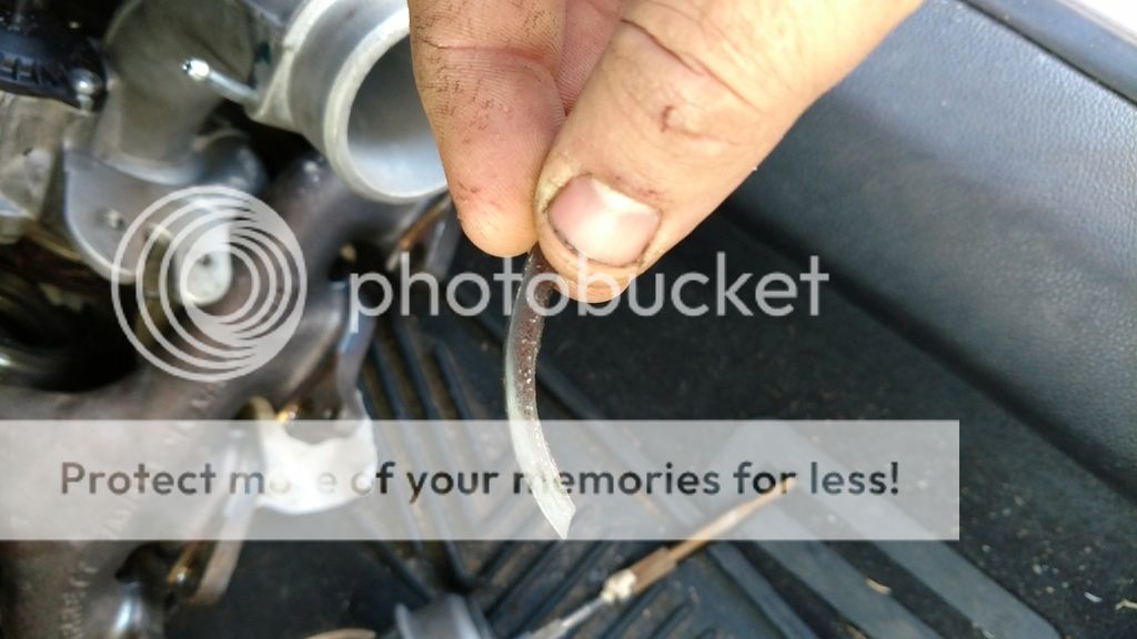

I called it a night and started in on it the following day. My buddy and I get the new one installed without much fanfare, pour in the coolant, start it up, and instantly hear a noise. After double checking everything we notice the compressor to turbine clamp is loose. We tighten it up and start the car up again. Everything sounded great, except the extremely loud purge solenoid my car has. I take it out and it is a complete and utter dog. Thinking the dent in the was worse than originally thought I swapped the old actuator in and that didn't fix it.
This is what I was seeing for "boost" on TorquePro with the pedal being pushed through the floor.

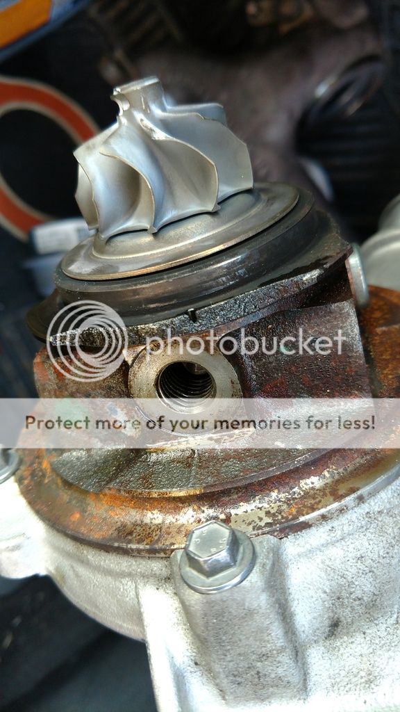

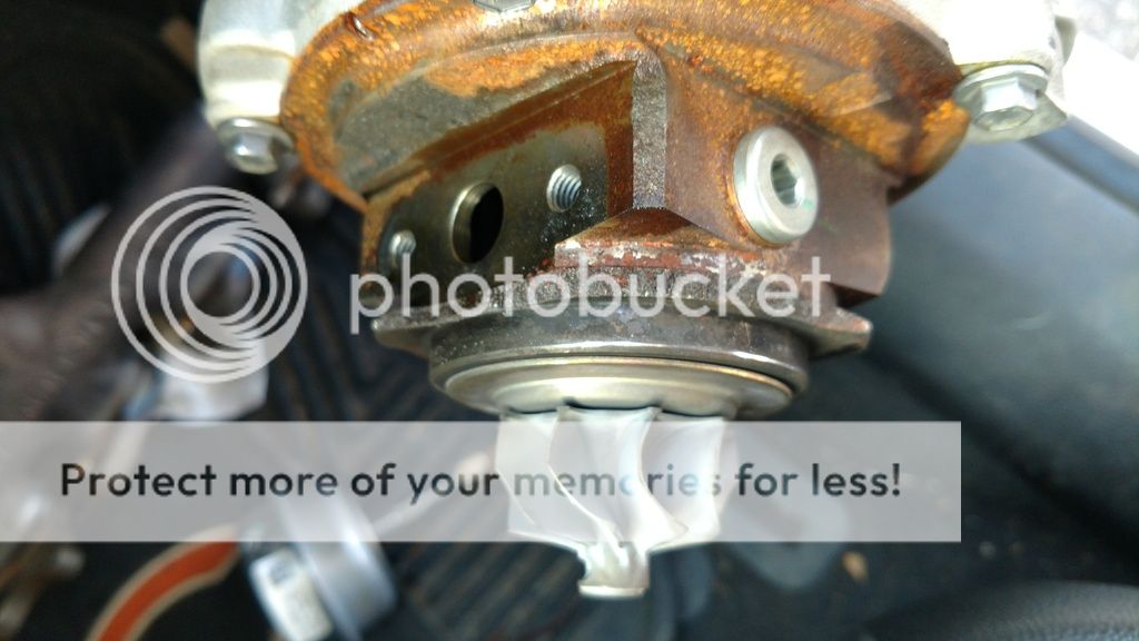

Tear down #2 commenced. After getting the "new" used turbo out my friend and I realize what is wrong. We had a piece of flange fall out of the clamp while pulling the turbo out. We separated the compressor and turbine to find this.
This morning I called up the place I bought it from and they are stepping up and taking the turbo back.
Now what's next. The car still pulls 10-11lbs of boost with the cracked housing and loose wastegate, so I don't have to race out and buy another one. I am completely done with used. A new one is what will be put into my car, but the question is do I just want to bite the bullet and go with the SuperGT14 from VT or get a stock new one from the dealership. Since my turbo is junk the $400 core from VT will need to be factored into the price and $1300 is a tough pill to swallow. Whereas the new from GM one would only be $600 locally.
I have HP tuners to tune for the new turbo and do not plan on running meth or E85 to start.

How does that big of a flange piece of metal just fall off? It was on the new Turbo when installed? The surface of the metal looks like a dirty break not clean metal. So I guess the flange was stress fractured either in the accident of the donor car, or removal of the turbo for sale?

It had to have come from the accident. I was trying to take the oil/coolant block off of the old turbo and accidentally hit the flange with a hammer and it did't break, so I know it wasn't done it shipping or during install.
