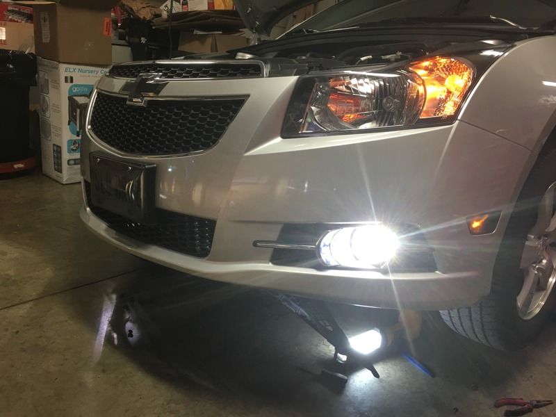

Tonight i installed my Diode Dynamics XP50 Backup lights and XML2 Fog Lights
Fog Lights:

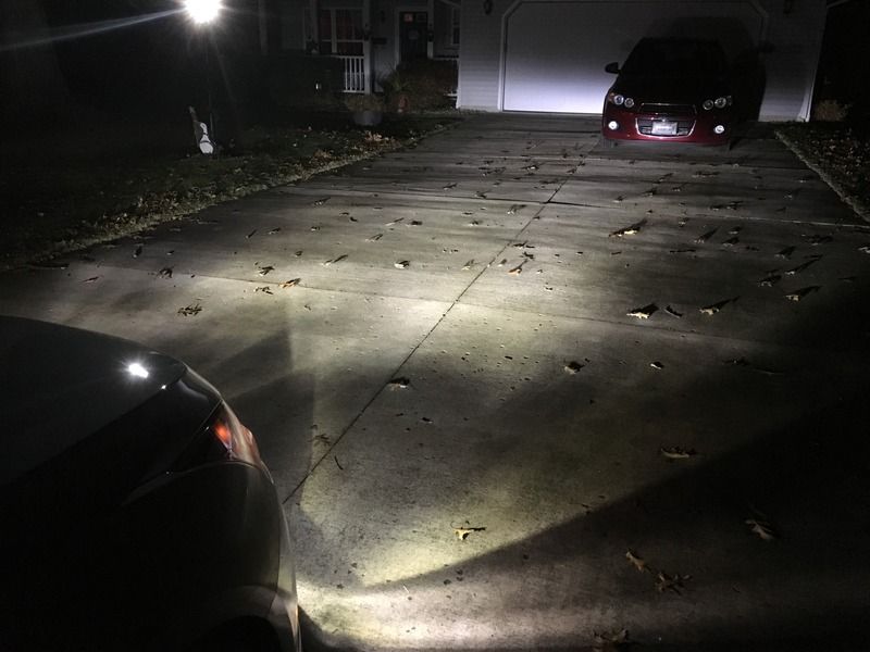

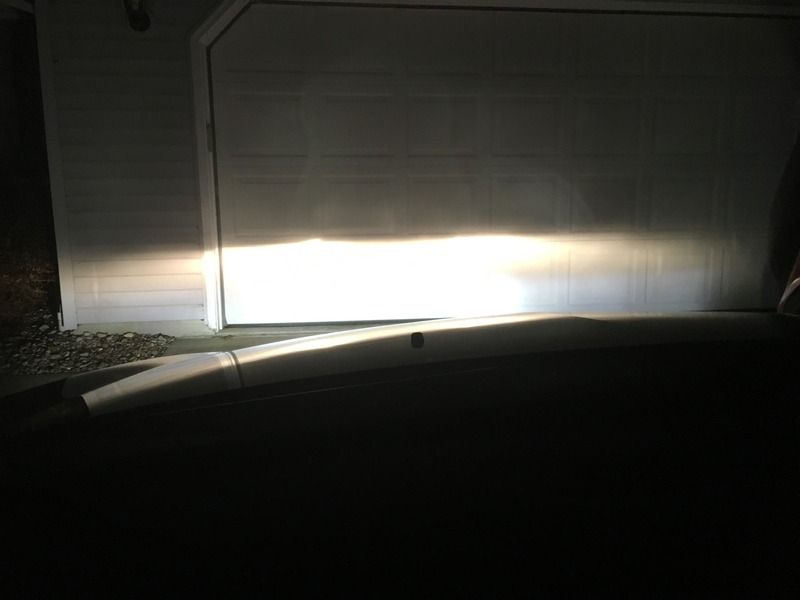

Almost looks like it has a cutoff:

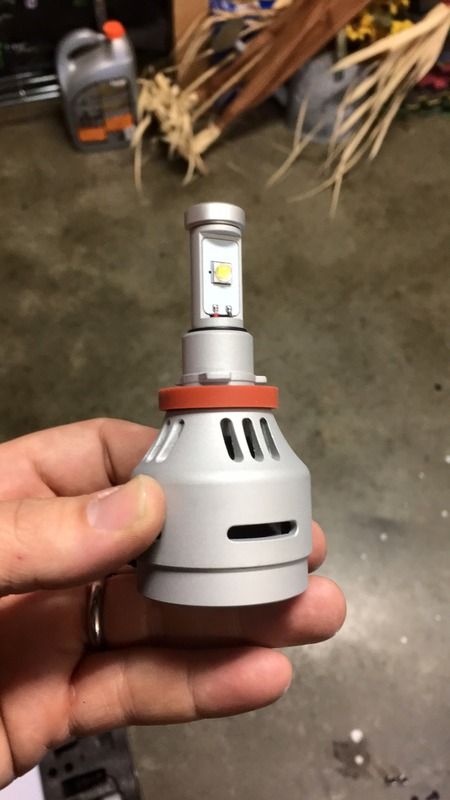

What kind of bulb is that? H8?
