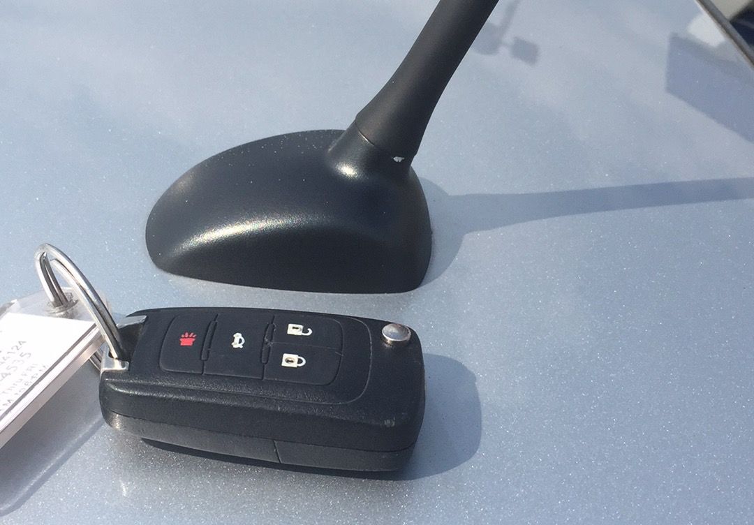

Wait so exactly how are you guys adding shark fin antennas to the 2015 chevy cruze. The radio antenna mount is huge. Are you guys cutting it? And about the verano. Are you guys replacing the oem antenna mount with a verano radio antenna?
That's a good question how others made it fit w/o a massive OEM Shark Fin swap. The WIFI capable cars like 2015 and 2016 limited Cruze have a larger base than the regular 2011-2014 Cruze. The Shark Fin Made by Visual Garage came in 2 sizes MKI and MKII with MKII being the larger size. The Sonic and Cruze share the same antenna where the Verano doesn't. Doing a full out swap to the OEM Verano shark fin is a bit over the heads of the average person. There was maybe 1 or 2 people who did it but pics are scarce even before Photo Bucket situation took place.
Visual Garage says 2015 can have their fin fit if and only if the base is less than 5" length. Pretty much a 15 not containing WiFi from the factory like a fleet car or overseas market. I haven't seen the 2015-2016 Limited fleet base but this is a picture of the pre facelift Fleet Cruze no OnStar no XM antenna base however long FB allows me to post this.
So what do you suggest I should do. I have the 2015 Cruze with the massive radio mount. Do you recommend that I swap it with a 2015-16 Verano shark fin? Do I lose anything by doing this? I would like radio capabilities and don't really care about OnStar? Thanks for the feedback
Unless you find a full write up of what needs to be done exactly, you pretty much run the risk of possibly losing the entire antenna function, destroy the headliner, and void the warranty when you go in to try and get it fixed. If you can find someone who can do it "legit" and not "I'm sure I can YouTube it" them it could be possible. Same time you have to find out if the Verano had WiFi in the same setup or if it was separate like some of the GM trucks. When I searched threads from 5 years ago they also tossed in Insignia and Camaro but didn't specify if roof or trunk mounted. Then again 5 years ago WiFi wasn't a thought so you still risk losing that feature.
In short, you would be the 1st person to pay for and try it out on a 15-16 WiFi equipped Cruze. Any other thread that pops up won't be for the 15/16 with WiFi.
