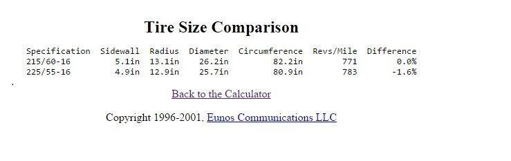

When replacing tires on modern cars, it's generally best to keep the revolutions per mile within 1 or 2 percent of the OEM tires. This keeps the computers and electronics working within the parameters they were designed for. As an example: if the OEM tires were 215/55, you might go to 225/50 with the same wheel diameter. Check the tire description specifications on tirereack.com or discounttiredirect.com to see what they are.

Tire calc below, May have to right click and view image as forum shrinks it.
From what I understand the 225s should fit with no problem.
