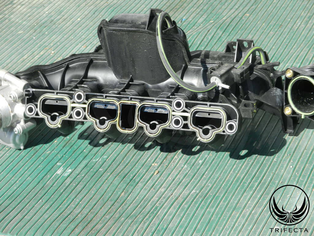

Figure 1 – Racer X Manifold for the 1.4L Turbo (RPO:LUJ/LUV)

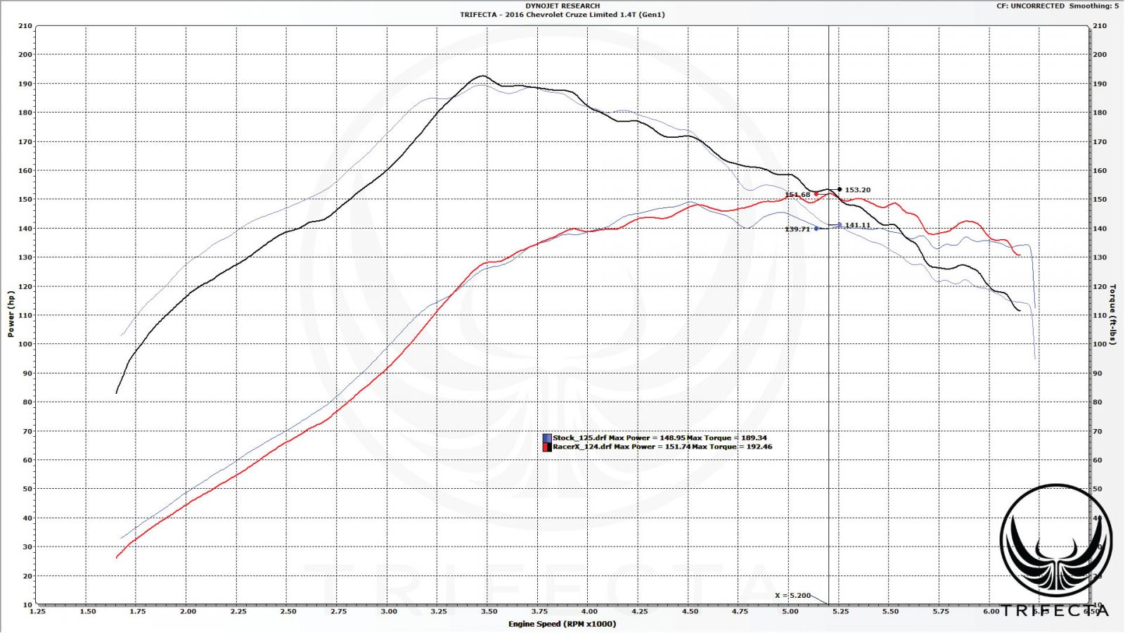

We found, with appropriate recalibration, the Racer X Fabrication intake manifold increases power as measured on the dyno, by up to 12 horsepower as measured at the wheel. Torque output peak was unchanged, but did shift up the RPM band by about 200 RPM (e.g. it took 200 RPM more to reach peak torque).
Figure 2 – Dyno sheet showing Stock vs Racer X performance
Beyond the power gains, it is our opinion this product will be popular in this market because it also permanently and effectively addresses the PCV issues this engine is known for, provides a custom upgrade part (and look) for these vehicles, and also allows for future expansion, as there are several unused ports in the end of the manifold which could be utilized for additional instrumentation, or water,
water/methanol, and/or nitrous injection directly into the manifold.

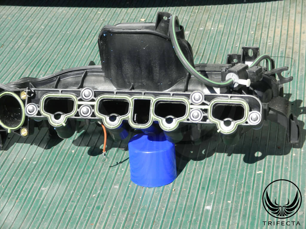

Figure 3 – Stock Intake Manifold with “air tumblers”
The OE intake manifold has a restriction in the runner near the intake port. It is believed these are actually air tumblers and are meant to induce intake charge swirl for more efficient combustion. However, it is also theorized that these air tumblers reduce and restrict airflow when higher levels of airflow are introduced (e.g. turning up the boost, upgraded turbocharger, etc.). We had performed a preliminary test on a ported manifold versus a stock manifold several years back and saw negligible change in power on the dyno, but a possible loss of efficiency (more timing advance was required to maintain similar power levels to unported manifold). Ironically, while the effect is the ECM reports the power output level has increased due to the additional timing advance (despite a wash on the dyno), the loss of efficiency could be attributed to less efficient mixing of the air and fuel charge due to the lack of tumblers, but a more conclusive test is needed.

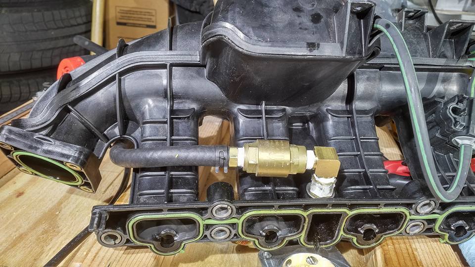

The PCV system modification addresses PCV system failures that are prevalent on this engine by utilizing an external, and more robust check valve for introducing PCV vapors back into the intake manifold. This is achieved by installing a brass fitting in the bottom of the PCV chamber in the intake manifold, routing the PCV vapors either to a throttle body spacer, or the brake booster fitting.
Figure 5 – OE Manifold PCV Modification
While both of these modifications are popular in the community, they are also considered do it yourself (DIY) modifications which require special tools and skill.

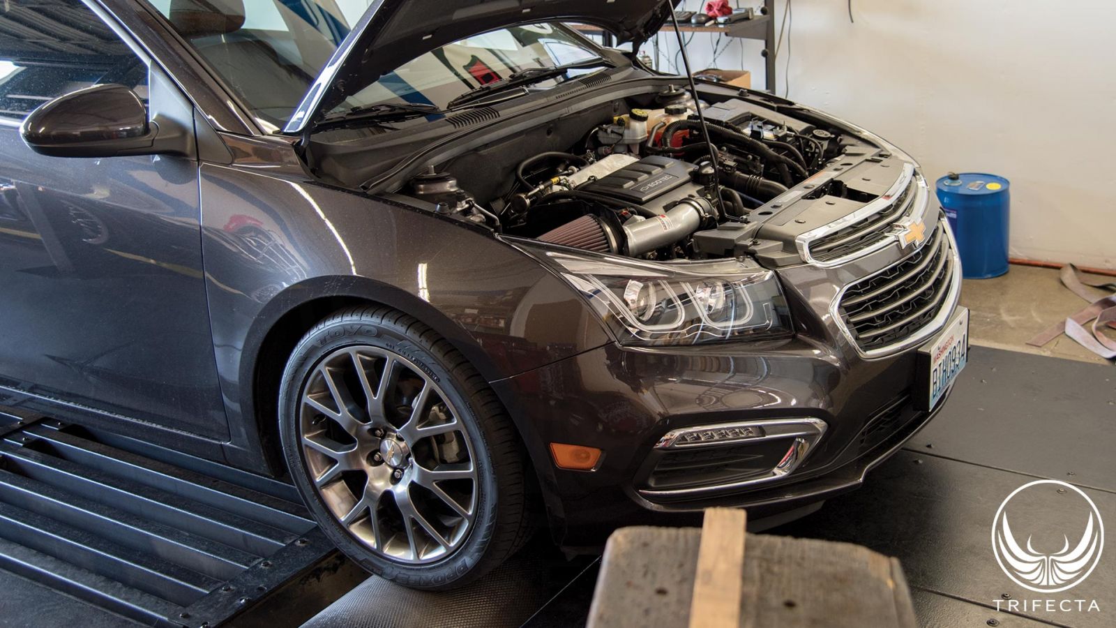

In order to keep the test results as accurate as possible, we tested both manifolds on the same day, on the same vehicle, on the same chassis dyno, back to back. We tested the Racer X manifold first, since we had installed it previously for calibration procedure. After performing several test “pulls” on the dyno, in manual 4[SUP]th[/SUP] gear, we let the car cool down, installed the stock manifold, warmed it to operating temperature, and performed several test “pulls”. From the beginning of the test procedure, to the end, the ambient air temperature only changed about 2F. The dyno used was a Dynojet 424xLC all wheel drive dyno equipped with eddy current load cells (but were not used for the test).
The vehicle was operated in manual 4[SUP]th[/SUP] gear for all test pulls. After the dyno brake was released, the vehicle was put in manual 3[SUP]rd[/SUP] gear, run up to 20 MPH, shifted to manual 4[SUP]th[/SUP] gear, then decelerated to 1100 RPM, and then a wide open throttle maneuver was executed. The vehicle was operated until 6200 RPM, and the dyno “pull” was concluded.
Figure 7 – Test Vehicle on the dyno, with Racer X manifold

When we performed the final back to back test on the dyno with the Racer X manifold vs the stock manifold, the following airflow and pressure statistics were observed:
Airflow (mass air flow sensor) lb/min, 6020 RPM and Manifold Absolute Pressure:
Compressor inlet pressure: 98 kPa
RacerX: 18.55 lb/min, 211 kPa (113 kPa, 16.385 psi boost)
Stock: 18.32 lb/min, 227 kPa (129 kPa, 18.705 psi boost)
At 6020 RPM, in both cases, maximum pressure is obtained from the compressor. However, despite the manifold being at almost 2psi less boost pressure RacerX vs stock, the airflow is still higher, which is a more accurate measure of performance.
We also sampled the data at 5500 RPM, the airflow differences were more pronounced (with similar manifold pressure):
RacerX: 18.62 lb/min, 229 kPa (131 kPa, 18.995 psi boost)
Stock: 17.52 lb/min, 225 kPa (127 kPa, 18.415 psi boost)

- My PCV check valve fix doesn't require special tools. I bought my three-pack of step bits from Menard's. Harbor Freight had them as well. A step drill bit is a very common tool that can be find at any hardware store. Of the 352 kits I've shipped out, nobody has noted they had difficulty finding the tool at their hardware store.
- My PCV check valve fix doesn't require more skill than does installing this intake manifold. If you can drill a hole and turn a wrench, you can install my kit.
- Both my PCV check valve fix kit and this intake are DIY modifications, so I'm not sure what the purpose was for mentioning that.
