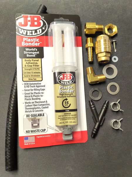

Actually you could use any version as it depends on what else you do or do not do. EDIT: I would ask him if he still has the Bonano valves and what version(s) can you get it with. This will be the most expensive route to go, but the best for reliability.
I am going to assume you will be installing a throttle-body spacer. For that I would install V1 as Cruzin2011 says, assuming he still has some available. I suggest you purchase a
BNR spacer. I personally have a
DDMworks spacer and used what I would call V0.9 as it required another fitting to make it work. That also entailed removing or modifying an engine lifting point. I suggest not going that route. I think the DDM spacer was made for the Sonic, but it will work just the same.
Now having said that, V3.1 is the easiest route to go and adds at least one more fix to other issues, but I really like the Bonano valve over the cheaper plastic one. He has been progressively making the kit more affordable for those who do not have a lot of money. for that matter, he gave the instructions for making your own, but really he has been able to buy in bulk so most of the parts he will have at a better price point.
I would spend an hour or so and look at all the different posts he has created here and on Cruzekits.com There are also many youtube videos he has made as well.
If you are really that concerned about messing up your intake, buy an intake that has the valve missing from someone here that decided to g with the Dorman or even a new GM part. should be able to get it very cheap. Then install the kit. That way you have a somewhat running car if yours is already blown and you will have the time to be methodical in your installation of the kit. You can then see the plastic piece (or as I did, a screw), being inserted instead of trying multiple times.
For those who want to go the easiest route, the plastic pin in V3 can be installed without removing the manifold, but at a cost of being a bit more difficult for some.
Lastly, the latest version also replaces the crack-prone corrugated/accordion hose going from the manifold to the turbo inlet.

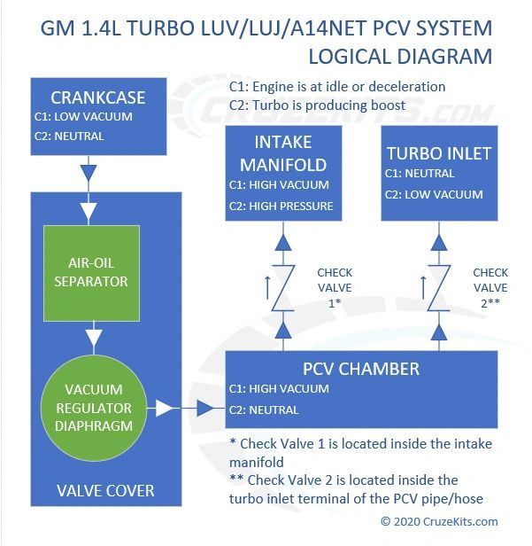

2011-2016 Cruze 1.4L PCV Valve Cover/Intake Manifold Issues Video: I made a video to help better explain how this whole PCV system works to supplement this article. Overview I find myself having to explain this issue to someone almost daily, so in the interest of brevity, I'm creating a...
www.cruzetalk.com
2011-2016 Cruze Limited 1.4L PCV System Explained Video: I made a video to help better explain how this whole PCV system works to supplement this article. Overview: The purpose of this post is to explain the function of the PCV system in the 1.4L Turbo engine so those of you who are having...
www.cruzetalk.com
Everything you need to know about the benefits and purpose of a fully-functional PCV system and why you shouldn't just bypass the whole thing or vent to atmosphere.
