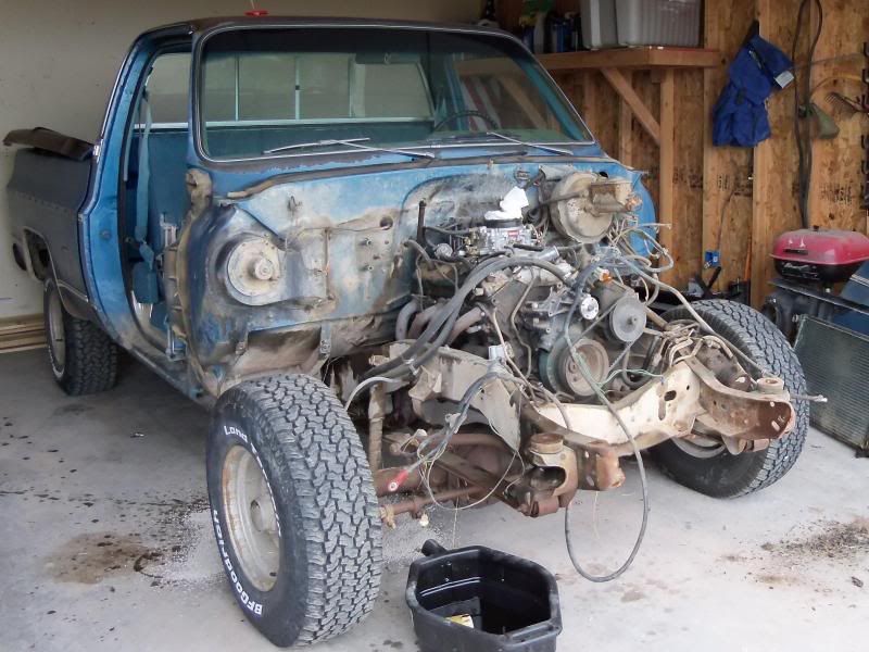

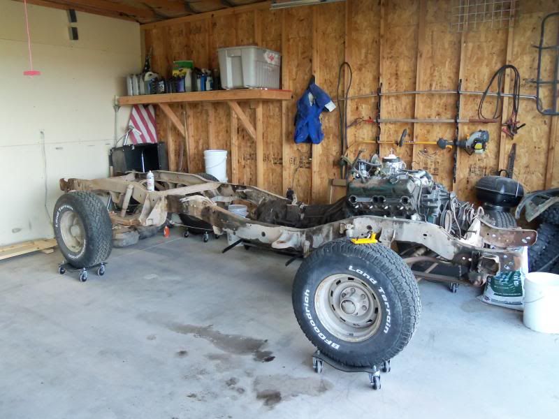

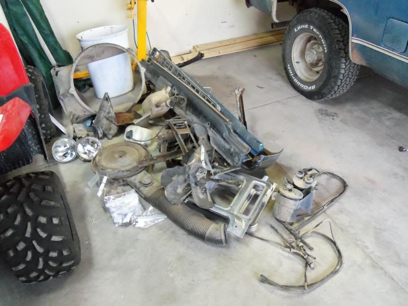

So here I am, starting a project that I'm most likely hugely unprepared for. I'll be doing all of the work that doesn't require a specific skill set. I'll start with removing the body, working from the front to the back. Removing everything and storing the body until it's time to take it to the body shop. The engine I'll be stripping to a bare block and giving to the local machine shop for cylinder work, clean up, new cam bearings, and over all health check. This is of course assuming that there is not catastrophic damage. The trans and transfer case will be pulled and sent to the trans shop to be gone through and all seals replaced. I have no problem working on all of the other mechanical parts in the truck, and if it was a manual, I'd dive right in. However, auto transmissions are magic to me, and I have no desire to screw this one up. That leaves me a rolling chassis. I will then work from 1 end to the other removing all bolts and fasteners, cleaning up all parts, replacing bushings/bolts/etc, and painting all of the parts. There will be parts that I may or may not reuse depending on condition, but cheap parts and safety parts will be replaced regardless (brake lines, hoses, etc). I'll be replacing all of the wiring also, after 30+ years I don't trust it, and it's another of those "Since you're there, do it right" situations.
