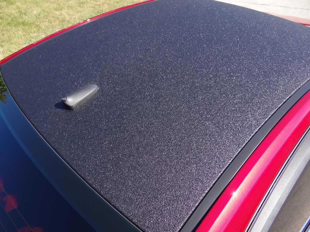

If you do the roof you will need to get a sprayer. The cans will not work on the roof. You won't be able to get a nice even coat using the spray cans. It will turn out looking like you have darker stripes going down your roof. I tried this probably 4 times using about 12 cans of spray and it never turned out smooth. That is when I went with a LineX roof.
