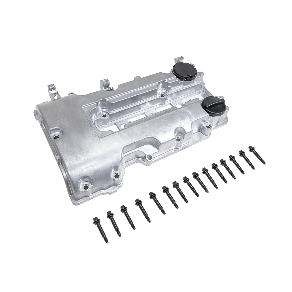

2nd doreman cover keeps leaking around the odd kick in just to the left of the dipstick.
The OEM failed and warped around the egr openings.
The 1st and 2nd doreman covers did the same.
This 3rd one brand new 10 miles later is wet with oil right at the same area.
I checked the surface with a straight edge. Its flush.
Any good valve cover replacement options? A $10 metallic would be an improvement over the $100 plastic ones

Other then an aluminum cover, and goo-gob RTV all over the lower left corner of the cover gasket, which is unnecessary, wtf? I'm stumped.
