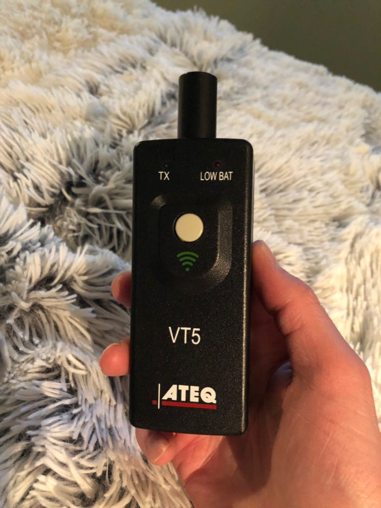

They apparently have gone down in price haha. I think I paid 65 used from another member years ago. They didn’t used to be that cheap.
The only thing I know is that this specifically works on our models because I used it.
Would take offers but probably just worth me keeping it I guess.
Sent from my iPhone using Tapatalk
This procedure doesn't work for all people?
Not on later Cruzes.

Looks like the gen2 can possibly be done the same way. I figured out how to access the relearn.
Starting with the 13' and up model years, no GM vehicle can be done by dropping air pressure. You have to have a relearn tool. I too did it the way the video showed and never had an issue on older GM vehicles. I bought my tool in 2013 and cost me $75. Same tool now can be bought for $16. I would rather use the tool anyway. Super easy and fast. Can do all four corners faster than it would take to do one like shown in the video.
Right- when the factories overseas get our tech... IE cell phone charging cables etc haha
Again if anybody actually wants it, make me an offer, then at least you know this one worked because I used it, and you’re dealing with a US based seller :)
Yep. I'm finding that out.
And I really didn't wanna buy a tool that'll probably be lost the next time I need it. ? in 18 months.
Any recommendations on a universal brand?
Iif I'm going to buy one. I'd rather it be multi brand capable. Instead of Chevrolet specific. I can use it on other cars. And not have to buy another one when i decide to sell my cruze and buy something else.
Software upgradeable with pc would be a nice feature also. :)
