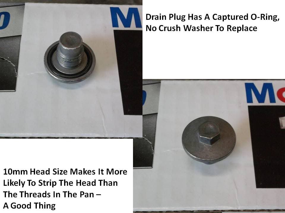

Does anyone have any tricks to not strip the oil pan bolt? I have gone through two bolts and can't seem to change the oil without stripping the head. Any advice would be appreciated.
