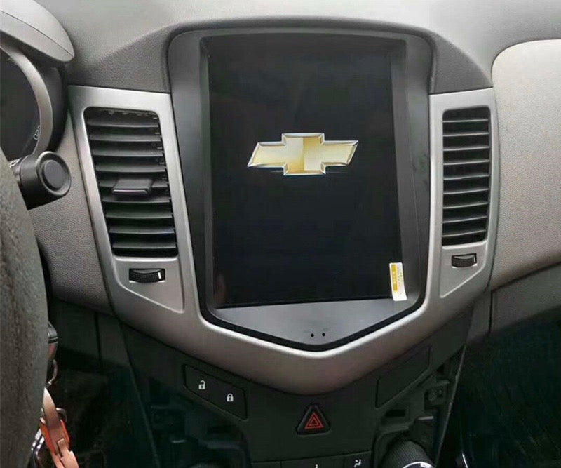

Installed mine last week. Everything works as it should. It was advertised as an android 8.0 but its actually 6.0. That's my only complaint. That and I cant get disney+ installed

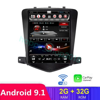

This is the one I got. But it doesn't connect with 9 speaker system and mines missing connectors for can bus. So I'm working on the resolution.
Do the steering wheel controls work?
What does the can-bus connection do? Just the tire pressure?
Yes the steering wheel controls work. The can-bus honestly I don't know. I want to research more and make sure I get all wires needed reconnected.
