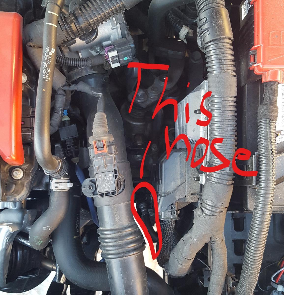

Pop the hood and look between the the engine and the battery. Between the charge pipes.
The hose connects to another plastic piece coming out of the transmission, on the end there is a "valve" to bleed the transmission fluid. That will be called the top of the "T" The bottom of the "T" will be the hose. Note, the following image was taken from underneath the car:
Between that hose and the top of the "T" will be the CDV.

For anyone who has trouble with this DIY, just follow the clutch hose down to where the bleeder is. You'll see that little delay valve, pictured 2nd from the bottom in the original post, connected inline after the clutch hydraulic hose. This mod involves removing that delay valve and plugging the hydraulic hose straight into the clutch slave cylinder; thereby bypassing the delay valve and eliminating the restriction. Note that the Chevy Sonic does not have this delay valve; this was installed intentionally to help beginners learn how to drive a manual and can be safely removed. Just hang onto the clip in case you for some reason decide to reinstall it, although I can't fathom a reason.
